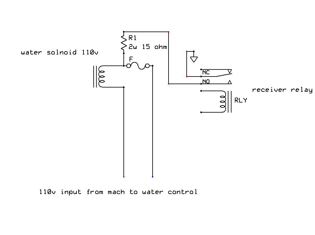

FIRST - why did you purchase a 6 channel receiver? you only need one per appliance.
seeing how the receiver is connected to power as is the appliance, everytime the customer unplugs the appliance the receiver is reset as well thus disabeling the receiver.
A cmos D flp flop would maybe work (unpluging then pluging back in may clock the D flip flop thus enabling the appliance. I may be missing somethig here but ??
My thoughts again (revised)
insert a fuse (110v line) to the water solnoid along with a relay, resistor.
relay controled by receiver. normally closed relay opens to disable unit and fuse is blowen so all the pluging and unpluging won' have any effect.
will draw schematic.
maybe way off in left field ??
here is a viable solution but every time you disable a machine you need to make a service call to replace the fuse.
the 15 ohm resistor is to prevent a direct short.
2 watt resistor should?? be big enough because the fuse should blow immediately anyway.
you just need to find out how mush current the water solenoid draws.
same idea could be employed for entire machine if its 110v. not suggested.
