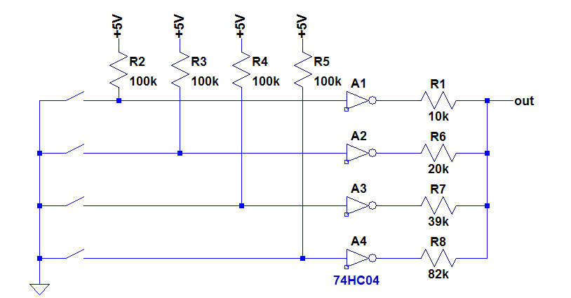

Hi guys,
I am fairly new to electronics and circuits and could really use some help with a circuit I have been trying to design for my Thesis. What I have is a joystick with an 8 way hat. I need to convert the signals from the hat onto one channel to send through to an external A/D card. My problem is the 8-way hat uses four buttons that when pressed determine what position the hat is in. eg: up, button 1 is pressed, Bottom right, buttons 2 and 3 are pressed at the same time.
I am trying to design a circuit similar to the one linked above, however I need each combination to have a distinct voltage drop so it can be interpreted by the computer running the system. I can not manage to get the parrallel loops to produce a distinct voltage drop from the single loops, ie when only one switch is closed. I know I have to alter the resistors but have had no luck finding a combination that works. Any help or advice would be greatly appreciated. Hope this makes sense. LOL.

Hi Nigel,
I understand about when only one switch is closed at any one time, however my problem lies in that when the hat is pushed diagonally two buttons are pressed. So it is no longer a simple series calculation but, there end up being two resistors in parallel. This results in voltage drops for the parallel circuit being too close to the voltage drops for the single switch series case. ie for the circuit linked in my first post the voltage drops are as follows:

switch 1&2 – 4.211
switch 1&4 – 4.0279
switch 2&3 – 3.3737
switch 3&4 – 2.33
As you can see there is a distinct voltage drop of about 1 volt for the single switches, but when a combination is closed, say 1 & 4 the difference is too small compared to the switch 1 case.
I need a distinct voltage drop across all individual switchs and two switch combinations. Is this possible?
Cheers
Danger
This simple 4-bit D/A may not give you optimum separation, since it has 16 possible output levels and you only need 8 of them, but it should give adequate separation.
For maximum separation, you could encode the 8 used output states into 3 bits, and drive a 3-bit DAC.

Hi Roff,
What I am unsure as to what the triangle symbols are. Are they a hex inverter. What does that do to the signal? and how can I check the voltage drops over it? Also I don't need to convert the digital signals from the stick as I am hijacking them before they get to the joysticks A/D, then sending them on to an Advantech PCL812PG board.

OK, I apologize for sounding like I was belittling you. I truly was curious.
The circuit I drew is just another way of getting a unique voltage for each combination of switches. With the scheme you posted, the smallest step was less than 50 mV. With the scheme I drew, the smallest step is over 300mV. This is easy to discern with a data acquisition system.
EDIT: I previously stated that there were 8 possible states, which you could encode into 3 bits and then generate a unique voltage for each state using a 3-bit D/A (digital to analog converter, which is what the circuit you referenced is also). I was wrong. There are 9 possible states, including when all switches are off (joystick centered).
