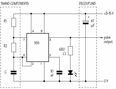

Recently I bought 1 PNA4601 IR receiver as well as 1 IR transmitter.
When I plug the IR transmitter and receiver onto Basic Stamp microcon and use the FreqOut command at 38500KHz, it works perfectly.. But them when I tried to construct a 555 timer circuit to send 38KHz through the IR transmitter, the PNA4601 receiver just cannot seem to detect the IR. I even put the transmitter soo close until both of the transmitter and receiver kissed each other and yet it doesn't want to work..
I have tried 2 different circuits with different components value for the 555 timer and both failed to work.
The first circuit I tried is found in IR_555Timer1.jpg attached below..
When I connect the output to the oscilloscope, it shows something like 70% duty cycle instead of 50%.

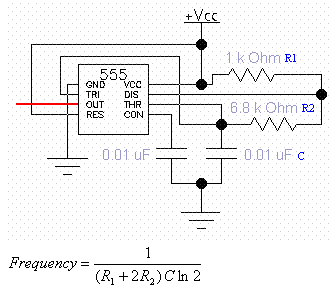

The second circuit I tried ia IR_555Timer2.jpg. The values for R1, R2 and C are 1K, 18K and 1nF respectively.. This time, when I connect the output to oscilloscope, it shows a 50% duty cycle. I even adjust the frequency to 38.5KHz with the potentiometer but it still refuse to work.
I have run out of ideas on how to make the IR work and am in desperate need of some help.. I have supplied continuous pulse of 38Khz and nothing seems to work.. Can somebody please help me..?

Some things to think about. Do you need 50% duty cycle? if not, then why didnt the one method work? Once you have verified that you can infact get a square wave working (555), make sure that the part you are using can source/sink enough current to fully illuminate the LED. I am not familiar with the basic stamp but output drive capability is one notable difference. Also, you can select resistor values to get you close to 50% duty cycle on the 555 circuit. I wouldnt worry bout that yet though. First make sure that you measure a good waveform on the output with the LED load. Maybe you killed the LED in the midst of fooling with it. DId you recently go back to the uC method to verify it still works?
Mr. Nobody,
Did you use a powerful 555 IC or its weak Cmos sister?
If you used the powerful one then your first circuit has an IR current very low and the second circuit has the current even lower.
The ouput voltage of an ordinary 555 with a 5V supply goes up to only 3.8v and the 470 ohm resistor in series with the IR diode limits its current to only about 5mA. 50mA or more should be used.
A Cmos 555 is not able to drive an LED high when it has only 5V for a supply.

I am not sure what 555 timer it is because it is my friend's.. But when I measure the output voltage, it is around 5V and the current is around 50mA.
Btw, i replace the output resistor of IR_555Timer2.jpg with 220Ohm only.. When I put a normal LED instead of the IR, the LED lighted up..
Hope that info helps..
Thanks..
Look at its part number. As shown in the attachment, An LMC555, TLC555 or Maxxxx is a Cmos 555 timer.
You showed a 5V supply and a 470 ohm resistor. The datasheet for a 555 shows a 1.4V loss when its output is high when the current is low and a 1.6V loss when the current is higher.
With the output at +3.6V, the LED is 1.5V and the resistor is 220 ohms then the current is only 9.5mA, not 50mA.

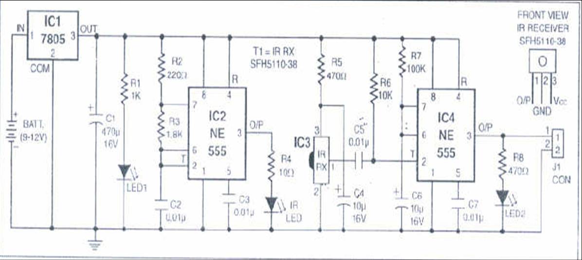

I think i know wats the problem...
Actually, nothing is really wrong with the circuit.. I think the minor problem is with the receiver.. The IR receiver that I am using only can only be triggered by sending a short burst of 38KHz unlike some sensor that can be triggered with continuous pulse of 38KHz..
I discovered that by accident while trying to remove the IR transmitter from the circuit while the power is on and putting it back (probably to change IR transmitter i guess).. Suddenly the receiver is triggered.. So I experiment by sending a PWM signal to the RESET pin of the 555 Timer and voila.. it works..
But another problem occurs.. the range is too short.. I will post the circuit soon to see what can be change to improve the range..
BTW.. the 555 timer I am using is NE555..
The NE555 is the original ordinary 555 that has up to 200mA output current.

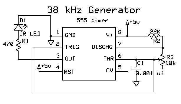

The frequency of the output of the 555 timer id determined by this.
For the duty cycle, (R1+R2)/(R1+2R2)
