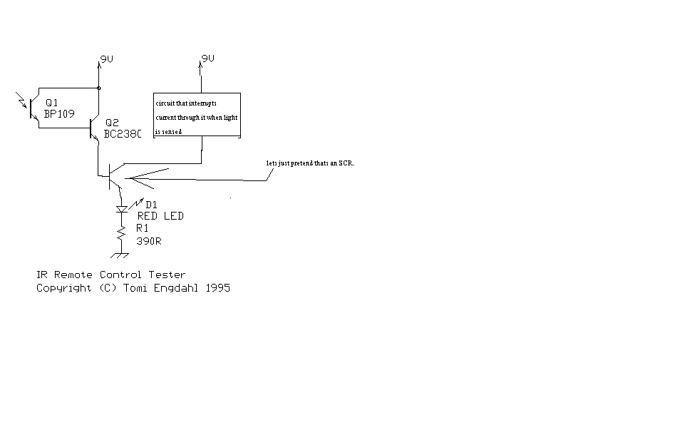

Yeah. do u know what an SCR is? When a signal is received @ the base of the scr (i dont know if im using the correct terminology, im just gonna treat the scr like a regular ol' transistor) it will let current run through the collector 2 the emitter. As long as this current runs through, the scr will stay on. if the current through the scr is interrupted, the scr will turn off. Thats the hard part. I think i have an idea, but i doubt that itll work.
Could someone else tel me if this is a good idea?: What i was thinking is just having an emitter follower circuit that turns off when it detects IR light where "circuit that interrupts current flow when it detects light" is.
I think if you're only 2 meters away from the circuit, it shouldnt be affected too adversly by ambient light, but im not sure. ive never done an IR circuit. hope this helps :D

So zachtheterrible, what your saying is, with your circuit, each time the reciever IR led receives a pulse from the Transmitter, and this runs through to the SCR it will change the state of the scr to allow current to flow to the LED? And vice versa, by interupting the SCR again, the state will be changed to cut off the circuit to the LED?
If so it sounds perfect, and, whats more "simple"
An SCR (Silicon Controlled Rectifer) can only be turned ON, not OFF, to turn it off the current passing through it has to drop below it's 'holding current', when it automatically switches OFF.
Also these crude schemes with a photo-transistor aren't going to be very reliable - they will be triggered by ANY IR source near by, and also by visible light. It's usual (for good reason) to use a modulated IR beam, the receiver then detects the modulation - again, usually, some kind of coding is carried on the modulation as well - in order to differentiate between different buttons and different remotes.
The simplest way is to use a standard IR receiver IC, as used in TV's etc. Then modulate your transmitter at about 38KHz, the output of the receiver IC goes LOW when it detects the 38KHz IR signal. This overcomes the ambient light problems, but still means that ANY IR remote control will trigger your device.
To cure that problem you can add coding, using either micro-controllers or specific chips (actually pre-programmed micro-controllers). This makes the circuit nice and simple, including the latching if you use your own micro-controllers - my PIC tutorials include this very subject, turning LED's ON and OFF via IR, using both seperate ON and OFF buttons, and a single button which toggles the output.

timothyjackson said:
I was going to be using specific frequency IR transmitters and receivers, with ambient light filters? will this not cure the problem?
You can't use a filter to prevent triggering from ambient light. There is some degree of IR in abmient light that makes it trigger. If you were to filter this out then you would also filter out the IR sent by the remote.

So far I understand your point about coding the IR signals, so that, the LED does what I want it to do, when i want it done. I was going to be using specific frequency IR transmitters and receivers, with ambient light filters? will this not cure the problem?
Ambient light filters REDUCE the ambient light, they don't block it, so they only improve the problem a little - most IR photo-transistors already include filtering in their encapsulation.
Using very narrow band filters and accurately tuned transmitters would work, but it's a very 1970's solution, and would be fairly complicated and expensive. Remote control has moved on a great deal since those old crude days!.
