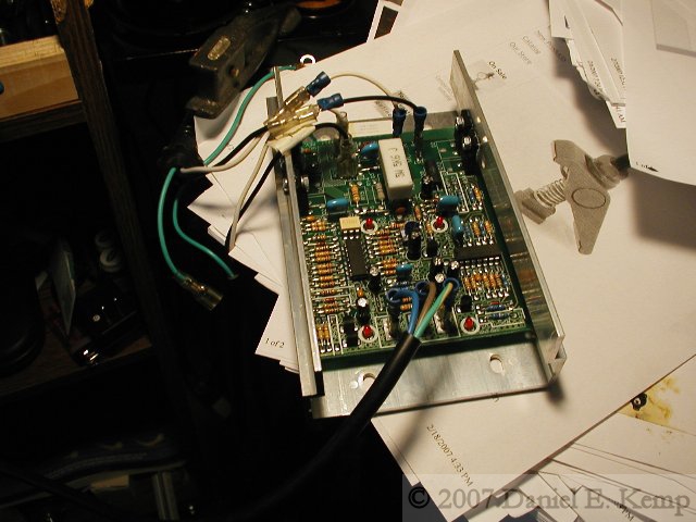

I assume that this means that the circuit board is the culprit here; however, one thing which I don't quite understand is that parts of the machine, which I assume are controlled by the circuit board are still working -- the elevation seems to be in fine working order and moves up and down as I change the display. Since I am a non-techie, I thought I would ask the question -- is it possible that only certain parts of the board are fried?
A vast majority of those motor controller boards (mounted near the main motor) are powered directly from the AC line without any stepdown transformer. Many of them are almost the same design with a few slight differences. Try eBay since often there are many of them to be found there for cheap -- mine was listed for $60. treadmill parts, Sporting Goods, treadmill items on eBay.com
Many of the boards resemble this layout, perhaps yours is similar?
