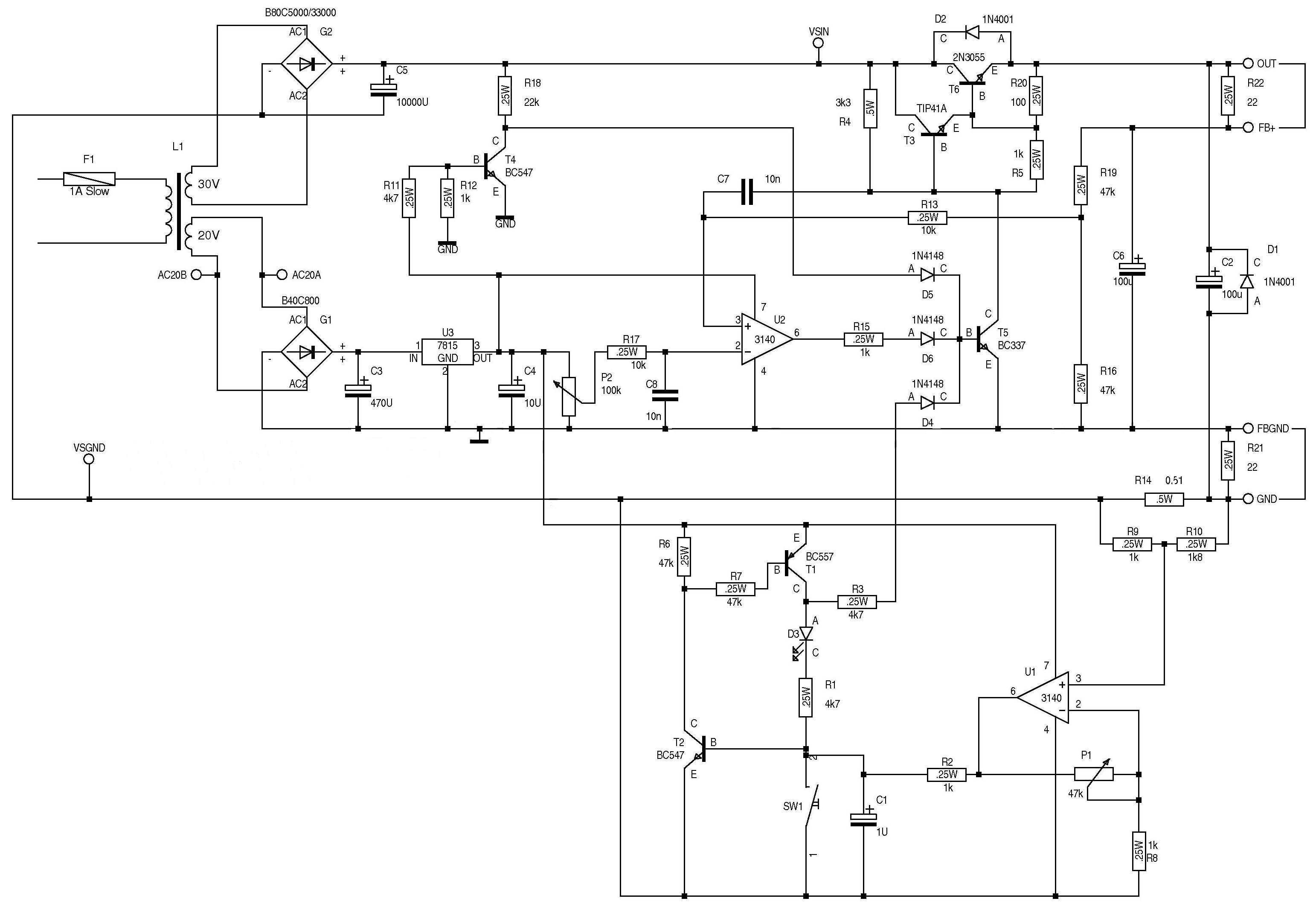

This is my first post to this forum. I am new to the field of electronics.Just took couple of weeks to understand electronics building by building small and simple transistor based projects.The only knowledge i previously have is how to make a pcb at home from given layout, never tried to design my own.Thought not having enough knowledge of electronics. So as with passage of time my knowledge of electronics is increasing, I am in my way to take some projects based on OP-AMP's. And just got free version of EAGLE layout CAD program to try my first Pcb.
As for know i need an adjustable lab power supply. i think not to waste money on batteries i had been using during all the time.
And even i have to still stuck to batteries, the rechargeable ones are an obvious choice.
Now the problem. If i stick to rechargeable batteries, i need a laboratory power supply to recharge them.Different types of batteries require different voltage and current to recharge them safely.
I can make a simple power supply with LM317. And for OP-AMP a dual power supply may be needed so LM337. But if i make these,the different batteries require to be charged at different current, So Lab power supply is must.And when i would progress in electronics field i am obviously going to need one.
I already tried some so called famous designs for lab power supplies, from famous websites, but some partially worked other's did not at all.
Now i need your help to design one lab psu. The last circuit i tried and build on a breadboard did not worked, the power supply did not respond at all to potentiometers.The output voltage remained same all time.I rechecked the breadboard connections four times and found no mistake,but it did not work.
I am attaching here the schematic of the said lab psu. lets see you people can help me by mentioning any defects in schematics and their solution.Please!
(Sorry for long post, i thought i should mention the background of myself and my problem so you people could take it with better attention).
Thank you very much.
I wonder if you could provide a reference for where you got your schematic?
One thing that struck me is your tapped transformer voltages. I'm seeing 20 V before your rectifier, then after the rectifier I see a 15 volt regulator.
Is the voltage printed on the transformer secondary indicitive of peak-to-peak AC? If that is the case, you will be getting less than 10 volts out of your rectifier and not enough to regulate at 15 volts. I would not expect to see a voltage printed on a schematic at a particular "test point" that isn't the value you would find. At the secondary there, you would be reading AC, voltage stepped down. There is no logical reason to print the half wave voltage at a point where it isn't read.
I am not sure if your fault condition reflects this observation, and it may very well be a non-standard representation on the schematic and meaningless. HOWEVER, if your schematic did not include a parts list, and you followed the meaning here verbatim, I wonder if you selected an inadequate transformer.
Here is the link to the website where i found the schematics.www.Hobby-Electronics.info - Electronics Course
Although the project is explained in details by the author.Yet being less experienced in electronics i just followed the explanation.The only thing i changed is that i am using separate transformers one with 30v secondary and other with 20v secondary.The author says its OK to use separate transformers.I did not changed anything else not even a single resistor value.
Please have a look at the project and give me some help. And if this project is absolutely not workable, Please let me know the website where i can find a really working lab psu or if anyone can give me a schematics of well working unit on this forum, will please me more than enough.
I can buy lab psu from many vendors but the happiness when as hobbyist you get some thing working by yourself will be pretty much gone.

If you have purchased all the components for this supply, I would not give up on building it. Even if it is complicated.
I am still "stuck" on the transformer being a possible issue. (Note that I may be overlooking a key item here, so hopefully someone will come along and correct any incorrect thoughts on my part)....
An LM7815 requires a minimum of 17.7 volts at the input terminal to maintain regulation.
So lets step through the initial circuit to the 15 V regulator. The output of the transformer says 20 V. OK fine then. Is that RMS value or half wave voltage? You would expect the AC RMS value, the voltage OUT at that point, to be what is printed there, no? The next step in the circuit is the B40C800 bridge rectifier. The datasheet for it says that the forward voltage drop per diode is 1 volt if I read it correctly, so you are rectifying the voltage, which is 20 VAC RMS, then rectified you have 10 VAC, minus the bridge voltage drop which appears to be 2 volts. You you are presenting 8 volts to a 15 volt regulator? That won't work.
Perhaps the gentleman who drew this meant the secondary after rectification would be 20V DC. That makes more sense, because the datasheet for the rectifier expects 40 volts RMS at the input. This would mean 20 Volts out minus the voltage drop, which would be 18 VDC, which is just above the regulator's minimum input voltage and would be an efficient scheme.
I am a repair guy, so I don't often replace transformers. They usually don't fail, but I would not ordinarily think transformer secondaries are rated for rectified voltages. That doesn't make sense, transformers are used for other things besides DC power supplies and this would create ambiguity. And my experience has never been to see this.
So, I believe there is a confusing ambiguity in this schematic.
Question, do you still have the transformer? You should disconnect it from the output circuit and connect your AC voltmeter leads to the "20V" secondary. Apply mains power. What do you read? If you are reading 20 volts, your transfomer is not adequate for the task, in my opinion. If you have 40 volts, then there is another problem.
And if the ambiguity is consistant, the 30 V secondary might be 60 volts instead. The circuit is a little less obvious at this point, but I can only conclude that both of your transformers are incorrect if you are measuring what is printed on the schematic.
I would attempt to contact the designer and clear this up.

The output of a power transformer is measured in volts RMS.
The 30V transformer is pretty good because its voltage does not go too high when it does not have a load (the 20V transformer is horrible because its voltage is 28V without a load).
When the transformer output is full-wave rectified and filtered with a capacitor then the capacitor charges to the peak voltage of the AC minus the rectifier voltage drop.
The peak voltage is 1.414 (the root of two) times the RMS voltage. A full-wave bridge rectifier has a voltage drop of 1.4V without a load and 2V with a few amps of current.
So the 30V transformer measured 31.9V RMS without a load. Its peak voltage is 45.1V and the rectifier drops the filtered voltage to +43.7V. He measured 41.6V which is close.

Yes, yes, yes. Doh!!! Dumb dumb dumb me for forgetting to account for RMS vs. peak voltage. That is as basic as it gets.
What irks me is that this is something I've forgotten more than once :)
Well, it just goes to show how easy it is to forget such details, especially when your troubleshooting over a computer.
Thanks Audioguru for setting the record straight.
From audioguru's post seems that he is also having the same view for faulty 20v transformer. I think i should buy a knew one from different manufacturer.And see what happens.But its going to take few days.
Before you do that, I think this long post could have been avoided by asking you to measure voltage after the regulator. If it is right at 15 volts it should not be an issue anyway as long as it doesn't intermittently get hot and "drop out".
I apologize for the long posts overlooking such a critical detail. I pride myself on being helpful and sharing knowledge but my brain is like a computer with a virus sometimes and "files get corrupted" LOL. :mad: mad at myself!
