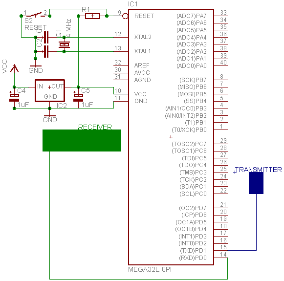

its really useful for me.ill use the schematic. but i have a couple of doubts.
in the circuit what is the value of R1,what is IC2 and Q1.u didnt specify the values of them
ill use this circuit but with a different IC may be ATtiny2313,and ill use avr studio to program it instead of assembly as i am not aquited with it
The above one is not my circuit.i just copied refa's circuit and attached it for reference.can i use any micro or is there any restriction on what micro i am using
You can use any micro you like, it's just a question of writing the code for it. I notice the AVR circuit uses the TXD (internal UART) pin, this generally isn't a good idea, you can't reliably send normal serial data via a radio link. Again, try reading my tutorial at , which explains why.
As for the circuit above, it's just a standard micro-controller basic circuit, IC2 is obviously a 5V regulator (7805 or similar), Q1 is a 4MHz crystal (and is labelled as such), and the resistor is just a pullup resistor for the reset pin, and won't be at all critital - 10K should be fine?.

I am using the ready rf module for serial data trans.
both end is working nicely [ tested on pc terminal ] but at the recevier side rxd_rf_moudle
send the data [ 00h ] continiously , which [ will ] make me difficault for work in other routine than the serial.
any simple solution to this simple prob. except any software logic.
thanks for your reply
If you read my tutorial it explains why, to do it properly you need to use Manchester coding (or some other NRZ system), although a 'bodge' which might get it working to some extent, is to add hardware inverters at each end.
i read your tutorial in that part,what you tell might be right,i understood the way to invert the signal and send it but wa not able to understand manchester coding.i just need send 0001,0010,0100,1000 throgh serial port and receive it a distance of 4 meters and contol a stepper motor using a FPGA,nios II processor.i can do the fpga part if i am able to receive the signal correctly.
now tell me for this distance and the above mentioned data transfer does the inveting mothod work?
i think we can invert the input by avrstudio.
there is no need for me to transmit a continous stram of data just a 4 bit data
The inverting method works, and 4m is no range at all - it's very easy to do, and shouldn't be a problem - I would suggest, as you only need four bits, that you use the other 4 bits of the 8 bit word to apply a little error checking, something as simple as duplicating the first four bits, but inverted, would provide some degree of error checking with little effort.
