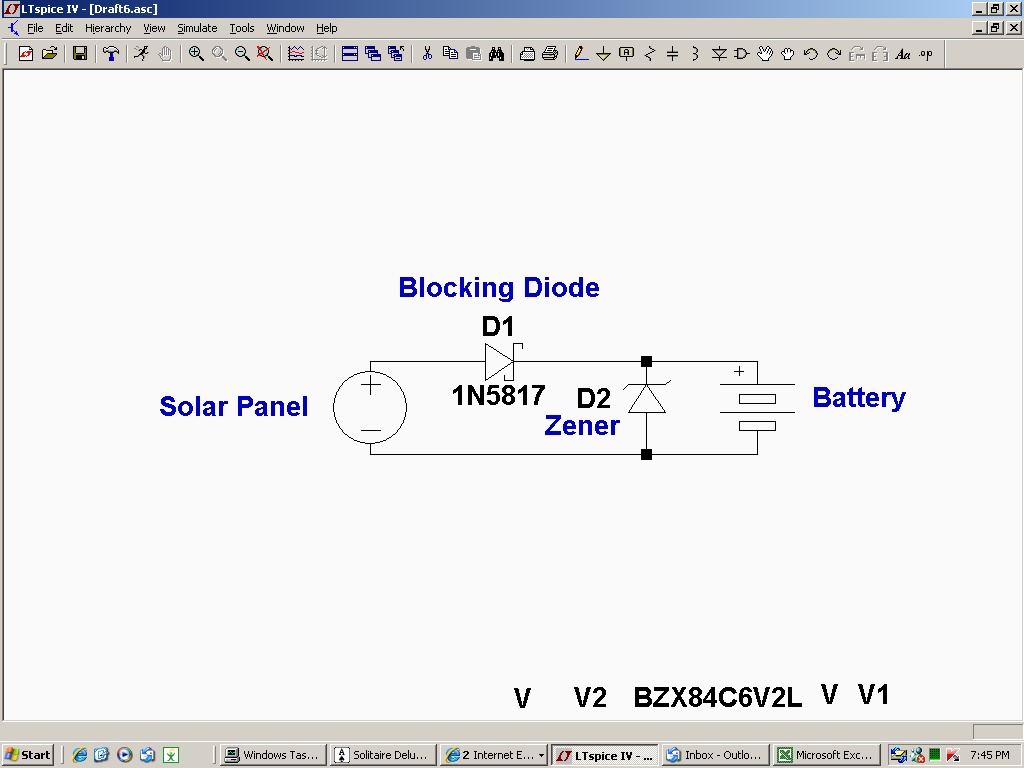

Hello,
Could you please help in the construction of a solar charger. My solar panel is rated as 6V,3W and i am looking to charge a 6V,5AH lead acid battery. If i am directly connecting the solar panel to the battery its working (voltage of about 6V to 6.5V and current of about 175mA) . But if i am connecting a 6.8V zener diode in parallel to the battery for over charge protection , its not working.
I think when using zener diode in parallel to battery, all the power from the solar panel is is drained via zener diode and battery is not getting any power.
Is my understanding correct ?
Could you please help how to charge the battery with over charge protection or detection?

Zener voltage varies some with current. You probably have it backwards though. The cathode (side with the line) should be connected to positive on your charging circuit. Normal charge voltage for a 3-cell lead acid would be around 6.9V-7.3V so you probably don't need it anyway.
You need a diode in series with the positive lead of the solar panel and battery and you need a few more cells to increase the charging current to 300-400 mA.
You need a simple circuit to "jack up" the output voltage of the solar panel to charge the battery.

6-6.5V at 175-200ma for a 6V 5AH lead acid would barely qualify as a preservation charge. You could probably supply it for the life of battery. Note that the battery will never reach full charge. The diode that colin suggested is a good idea to prevent back flow of current but unless you boost the output voltage, you probably can't afford the voltage drop, make sure to use a Schottsky if you do that.

Attached is a picture of how to hook it up. You need the blocking diode to prevent the battery from discharging thru the solar panel when the battery voltage is higher than the solar panel voltage (solar panel in the dark). You may have a problem when you do this because it looks like your panel doesn't put out enough voltage for a 6 volt battery. But try it and lets see how much current you get. After that lets see if you need the zener to protect the battery from overcharge.

Hello,
Today I tried the circuit to charge my 6V 5AH lead acid battery with my 6V 3W solar panel. Today it was bright and bit cloudy, but not fully sunny, The following are my observations:
1. Open circuit voltage on my solar panel = 9.7V.
2. I Connected the battery directly to the panel via a diode. After connection solar panel output voltage was 6.5V, battery voltage was 6.18V and a current of 150-190mA was flowing into the battery. Does it means that the battery was charging and the circuit was working fine?
3. To the above circuit I connected a 6.8V zener diode across the battery (over charge protection) but it didn't made any difference. Is it because the input voltage from the panel was around 6.5V and zener diode was of 6.8V?
Please let me know if this circuit is working?
thanks
S Sarath
The circuit is working. You do not need the zener. A 5AH cell can take 50mA to 100mA all day long without overcharging. You are only giving it 190mA for a few hours a day and this will not produce overcharging.
Your battery will take over 28 hours to charge at 190mA so that if the sun shines 6 hours per day, it will take nearly 5 days to charge.

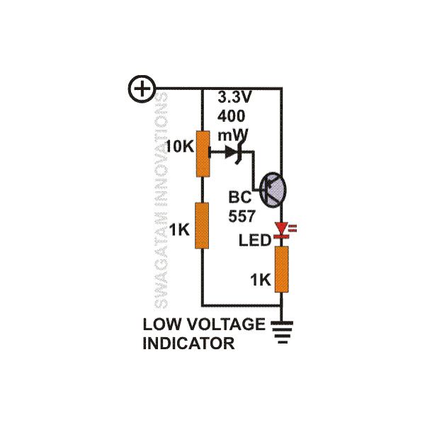

Hello,
Thanks for the suggestions.
Could you please advise on using the attached circuit for undervoltage indication for my charged 6V,5AH lead acid battery.
Shall i set the low voltage cutoff be about 4.5V for 6V,5AH battery?

It's OK, so long as you understand it works backwards. Meaning the LED will be on when the battery voltage is above whatever set point is. It is also customary to avoid wasting battery life by using a blink, instead of constant, maybe 1 second on 5 seconds off. You could accomplish both of those things (reversing the indicator and blinking) with a comparator and a 555 timer.
As for your chosen set point of 4.5V, that is not really low, it more like deader than a bag of rocks. Somewhere between 5.2V and 5.5V would probably be more appropriate. You should really do some research on lead acid batteries before completing the charger circuit.
