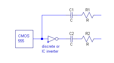

I have a 9vdc squarewave signal (7Hz), I would like to get plus and minus 5-8 volts out (with descrete components). So a 16 volt squarewave out with a common ground so it swings plus 8 and minus 8 volts (or 5 volts just more that 4.5).

It will be powered by a nine volt battery, the input is a 5VDC squarewave from a microcontroller. The output can be microamps, as I was going to drop a 10 meg in line with each lead. It will be used like a tens unit. I have it working now, with the 7660 and AVR 1200 for control. Looking to go to 555 and decretes if possible. But I need a plus and minus out and 15 volts of so peak to peak.
Will this work?
Theoretically, you only need one R and one C.

Nigel Goodwin said:
Ron H said:
Will this work?
Clever idea! - a bridged output, just like car audio amplifiers!.
Yeah, I was thinking that as I was drawing it.
Not the clever part - the bridged part.
I'm too modest to admit that I'm clever. :)

But until we were told what it was needed to do, it wasn't really an option!.

Thanks Ron H
Not sure if that will work, but easy enough to build and see.
I will have a 9V square wave out of the 555, Not sure how I will have a larger square wave (over 9V) out that swings plus and minus of a common reference point. Will be nice if it is that simple.

It's a standard technique called 'bridging', it provides twice the output swing of a single ended system - for car audio use a single ended 4W amplifier becomes a 16W bridged amplifier by using two anti-phase 4W amplifiers.

That is cool.. But would one R be my scope grounding point or the ground on the 555? It will be a square wave over 9V (say it was 14V) and I would see +7 and -7V?

Connect the ground of the scope to one R, and the probe to the other R, you should see a 14V-18V square wave - with the scope set to DC it should go above and below zero volts.
Most 10X scope probes are 10Meg input resistance. If you use one 10Meg resistor on your circuit, your scope will attenuate the signal by 50%, so you'll only see 9V p-p. If you use two 10Meg resistors, you'll only see 6V p-p. If you want to see full amplitude, measure on the other side of the resistors.

Ron H and Nigel. Thanks for the really neat circuit. You guys are great. Next time put more details in the question as not to fill up this forum so badly..
