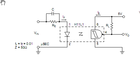

Can you post a sketch on how you have connected the opto [ in that pdf test mode]
Use the 'Manage Attachments' button lower down the Reply page to post the sketch.
This is from the data sheet, RL is 270R.

Yep, thats the Circuit. If I remember (from last night) (getting on a bit!) sourced the input at 7ma. RL= Vcc -Vd / 7ma. Id measured with Fluke.
That Cct with values as suggested (by Isocom) and Nothing! Current flowing through input (pins 1,2) so can only assumed not switching. But more than one Duffer in a batch of ten from RS?
When the LED turns on then the output is supposed to go low.
The LED is at pins 1 and 2. If you don't limit its current with a series current-limiting resistor then the LED will instantly blow up.
Rhe output needs a load resistor to the positive supply. If the output is connectrd directly to the positive supply then it will blow up instantly when it tries to go low.
Are you saying the test circuit is working.?:)
Obvious point, have you checked the opto's model number printed on the ic to make sure the ic's are what you think they are.?
I have had the wrong ic type in a correctly marked package, at times in the past.
Can you please post your circuit so that we can see what maybe wrong.

Audioguru. Fully understand all you say with respect to the input across the H11L1 (pins 1 and 2) as I said in first post, eventually will put LM334 constant current device on the input to the H11L1 because of the varying voltage applied.
Eric. With my failure to get the H11L1 working I connected it up as per the test switch circuit you posted on an earlier response This being the one from the data sheet (pdf) of the device. All voltages, resistor values as stated for the output side i.e 5v to pin 6 with RL 270r across pins 6 and 4. Looking back at my second post I stated that RL = Vcc –Vd / 7ma . My mistake. This would imply that the R was the load resistor across pins 4 and 6. It is of course the led dropping resistor( Re) for the input.
With respect Eric, I see little point in sketching out the circuit as it is basically the test switch circuit from the data sheet with a common VCC (5v) and ground and yes it is not working!! There is obviously something elementary I am missing because 3 H11L1s have been tried with no joy. As I said earlier, with a fluke between pin 2 and ground I can see 7ma so can assume that the input led is working UNLESS I have got the values wrong somewhere , but I do not think so. So to reiterate , with the device connected as suggested in the data pdf, for me, IT DON’T WORK!!!
My understanding of the device is that assuming current is flowing through the input the output should go low. This ‘low’ when measured at pin 4 will of course be Vcc minus the volt drop across the load resistor and I would expect to see about 1v this still being a Digital Low and also the voltdrop I would expect across the internal Switch (Transistor). The whole idea behind using this device was that with a traditional opto, indeterminate states were experienced because of the varying voltage input. Hence I am still hoping that I can use this device to give me two state outputs from a varying voltage input. If I can not get it to work then it is a trusty opto coupled to a Schmitt trigger. Finally Eric, how about you work out a value of Re ( the input led current limit) at a Vcc of 5v and I will drop that in . Maybe my understanding of the data sheet is wrong!!

hi Bill,
Can you try the follow test to the opto.
Connect a 270R between +5V and the opto emitter anode and the opto cathode to 0V.
This should forward bias the emitter.
Using your voltmeter, measure the voltage across the emitter, it should about 1.2v to 1.5V.
If you get a zero voltage across the opto, measure the current thru the 270R.
If you measure a current of about 20mA the emitter is short circuit.
If you get +5V across the emitter it could be o/c emitter.
If the opto emitter checks out OK, we will then look at the detector.
Hi Eric,
Voltage on pin 1 (after 270r) = 1.221v as expected. However this wasnt untill I dropped in my fourth H11L1, the previous one appears open CCt emitter as 5v seen after 270r resistor. No joy on the output side yet thou.

Again Hi Eric,
Well out of a batch of Ten (RS MIn Quantity) It would appear I have Five Duffers so far, difficult to believe!! Will re check them all and the remaining! Have now at last got one to work! Using RL (load res) of 270r.
