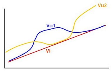

I'm looking for a smart solution to obtain a different gain for a not
inverting OpAmp The goal is have the same gain at the beginning and at the
end of the ramp source 0-5V DC signal (NO FREQUENCY) and a different gain in the middle of the ramp.
As example (where Vi= DC ramp signal, A=OpAmp gain)
Vi=1 A=2, Vi=2 A=1,5 Vi=3 A=1 Vi=4 A=1,5 Vi=5 A=2
In the attached img in red the source ramp, Vu1 and Vu2 the possible results
wanted
Thanks for any help
Do you want the Gain to change abruptly at these points or to change slowly as you have drawn?

hi brian,
If he wants abrupt Gain transitions I was thinking along the lines of using a dual comparator window detector
that would run in 'parallel' to the main amp.
If the comp window was setup at the transition voltages it could switch in resistors on the input of the main amp,
using FET's..
He may want a gradual change in Gain, he hasnt replied.

This thread is all over the place. How's about using a VGA (variable gain amplifier) and feed the gain control (Vg) a triangle waveform. So you get same gain at endpoints and a different gain at midpoint.
That's a nice idea. I guess you could do that using an Integrator. His variable voltage would be the input to the Integrator, and he would obtain your triangle waveform at the output which could be used to feed the variable gain input of the Amp.

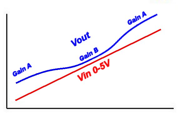

The solution that I’m looking for regards an improvement for some controls in the train plastic of a friend of mine.
The Vin = 0-5V comes from a position sensor ( I think a potentiometer).
Eric, your suggestion is a VCO + band pass filter, …correct?
Optikon, may you explain better your proposal?
Thanks to all of you……something of good is coming out!
PS
I added a new img reviewed (I hope more clear than the previous)

I think it would be useful for you to experiment with both of the ideas. Optikon's seems a little simpler than the VCO+filter idea, but personally I'd investigate both and then choose one based on circuit performance. Neither of them should be particularly hard to design.
Brian
Thinking about it though, if your input signal (0-5V) is always a slow ramp signal like you've drawn in your picture, then you won't need the triangle wave generator at all. Just some signal conditioning on the original signal and use that to alter the gain of the VGA.
Brian
