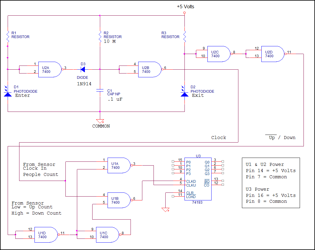

hey ppl, i need help for my final year project. basically, we are doing a open parking lot, powered by solar panel and batteries. we have IR transmitter and receiver at each parking lot. we only have 5, it is just a prototype. i still need to design a 7 display segment in order to show the number of available slot left, it will be much more useful. so this mean, the number shown on the display segment will always be 5 if there is no car, and if a car comes in and park, it will be 4. basically, just -1 from the base number. and +1 if a car leave the lot. what micro controller should i use? or if nt, is there any simpler way to achieve this? how should i go about doing it? i do nt have much time left to do, maybe abt 2 month. i need serious help, thanks alot.

There are several threads in these forums for and about "People Counters" where the people entering a room up count and those leaving down count. People in a room or cars in a lot, same thing as to counting. Do a forum search for people counters and you may get some good ideas using discrete components rather than a micro controller. I may have a rough circuit at home I could post later as at work now. There are plenty of other ways to do it. Think about it!

Before I forget, as mentioned earlier attached is a basic schematic of a people counter using old TTL chips. The values of R1 & R3 are determined by the sensors. If your parking lot exceeds 10 cars you will need to cascade the 74193 with another. This is a basic start to where you want to go using discreet components.

reloadron, that schematic design that you show me, is the link that -1 and +1 for car leaving and entering yes? just to confirm?
Yes, if a car (person) enters it will increment up 1 count and if leaving it will decrement down one count. You select the sensors based on what works for your application, also space the sensors on what works for your application. Read the data sheets on the chips used and understand the logic as that is what it is all about. You need to add a display and display driver obviously. You need to set up the 74193 to count to 5. Maybe if 5 cars enter and none leave a light comes on saying "LOT FULL". You get creative.
