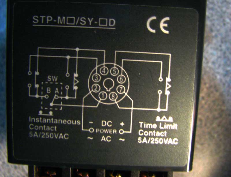

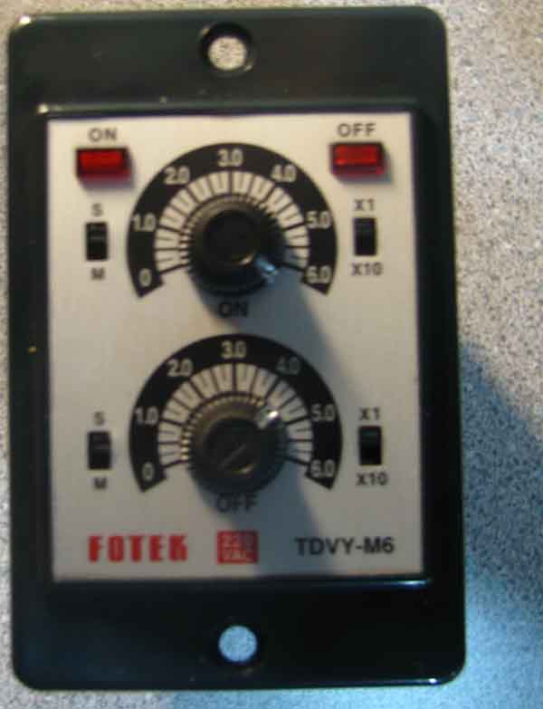

.My old timer has only AC male pluck for power to goes in and a female plug to connect to the load (solenoid valve) which is simple enough for me. but the timing is somewhat unreliable. So I bought this Fotek TDVY-M6(see pictures)
The problem is that now I don't know how to connect power supplies and the output to the terminals since now they are 8 of them.
Any help will be most appreciated.

The contacts on the right are controlled by the timer. So I would think you connect pins 6 and 8 in series with the solenoid value and its power.
The timer power goes to pins 2 and 7, of course.
