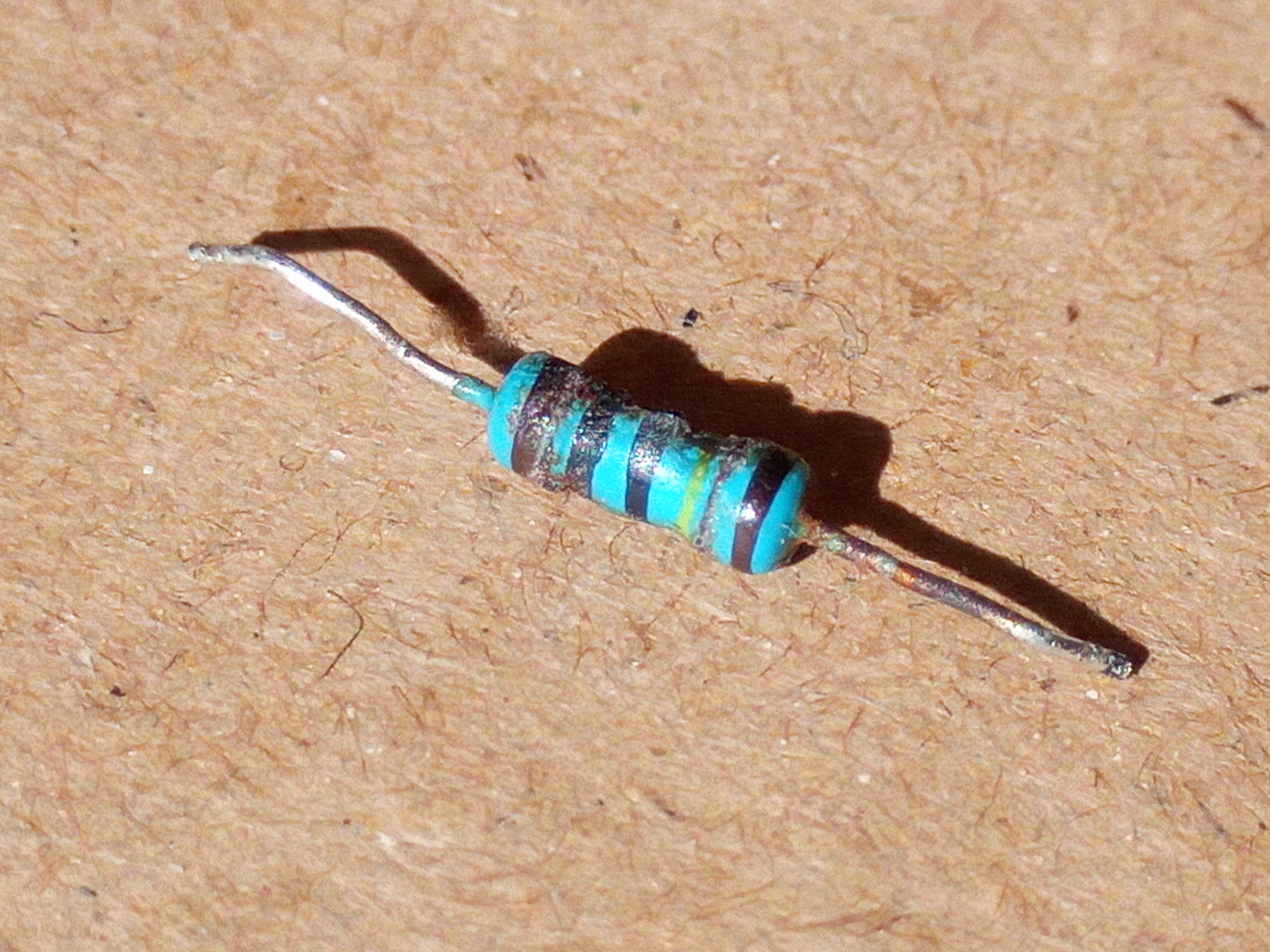

Hi can anyone help identify this resistor? Its burnt out (open) and the colors are tough to read. Any help would be appreciated.

it would be more helpful if you could let us know what device it was in and, even more helpful, show the circuit.
my first guess is a red, black, black, yellow (plus a tolerance color). So, 2M. Or Brown, black, black, yellow (1M). However, it is unlikely to see so much damage on such a high value resistor unless it is used In some high voltage device or damaged by a lightning strike.

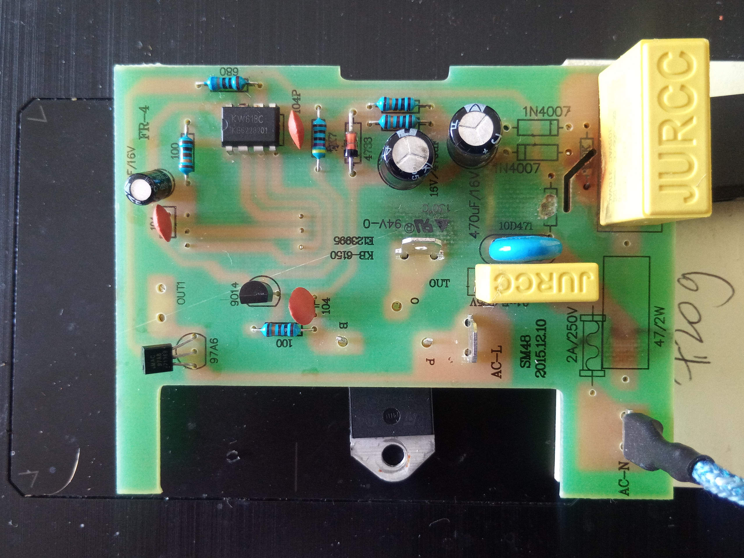

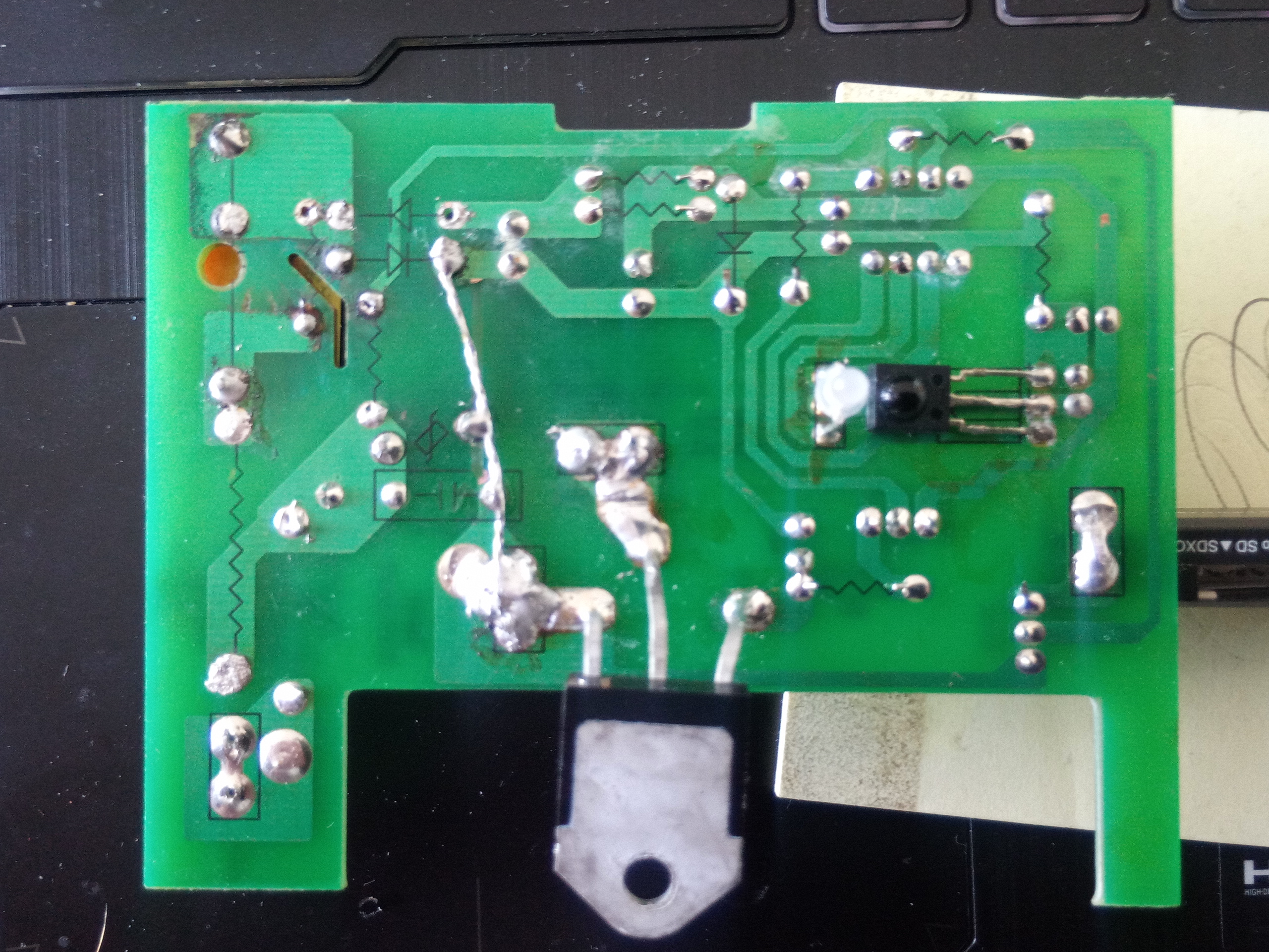

Thank you. I don't have a circuit diagram but its from a 220v 3kw patio heater with 3 power settings and remote control. The resistor goes between the 1n4007 diode and blue capacitor near the top right of the board. One end goes to the microchip (KW618C or KB6228201) and the other to the right lead of the blue capacitor. Top and bottom pics of the board attached.

It appears to be feeding zero-crossing pulses to the chip?, so is likely to be a high value resistor - so 1Meg is probably about right, assuming the colours haven't changed (and they often do).
As it's a high value, are you sure it's O/C? - did you test it on a high enough range?.
That blue capacitor is actually a thermistor - look at the back of the board.
Thanks for everyone's help here. The resistor was open, and burnt quite badly so colours were not true. I thought it might be 100 ohms but after all the feedback it seems that 1 meg is the right choice. I'll try it today. Many thanks again to everyone, its appreciated.

To be fair, modern 1% resistors are quite hard to read the colours on anyway, and colours very often change when overheated.
Assuming it is 1 Meg? - it's not really a value which you would expect to 'burn up', as it's power dissipation should be pretty low.
But fitting a 1 Meg to try should 'do no harm', as if it's supposed to be 100 ohm a 1 Meg is effectively just an O/C 100 ohm :D

Looking at the picture of the component side in post #3 it looks like more components have also failed. I have traced out part if the circuit. The power supply uses the yellow capacitor in the top right hand corner to drop the voltage for the electronics. It lookes like the discharge resistor in parallel with this capacitor has also failed. The fuse and the 47 ohm resistor in series with this capacitor have also been removed so I assume that these have also failed. The smaller yellow capacitor and the blue varistor are directly across the mains after the fuse. The fact that the varistor looks to be undamaged seems to rule out a severe high voltage transient on the mains as being the cause of the problem. Some history of the problem would be helpful. For example could there gave been a buildup of dirt on the board that has caused a flashover.

Basically there was a loud pop while the heater was on and a number of components cooked. The resister in question was burnt and open as was the 47 ohm 2w resistor plus the fuse and a land pattern that has a wire across it now. Anyway I replaced everything I thought was bad but when i connected it up the resister in question (1 meg) starting smoking so I turned it off. Obviously there is more wrong with the board so I may just give up and connect the heater to an on off switch. First time I have used this forum and I find the helpfulness of everyone is fantastic.
Makes me wonder if the resistor was actually a lower value (ie, tolearnce band is at the other end) and the chip (a z/c opto-triac?) is s/c.
I agree that if the resistor was 1 meg then it should not overheat as it would only be dissipating 62.5 mW even with 250 volts across it. I think the device on the etch side of the board is an infra red receiver for a remote control. I think the 8 pin IC is a special function device to interpret the infra red signal and control the drive to the triac. Eith the information in post #13 about the blown track I think the large yellow capacitor first failed short circuit. this would cause one of the 1N4007 diodes to fail short circuit so the mains was then short circuited via the 47 ohm resistor which blew the track and the 47 ohm resistor. I think the TS's solution of replacing the board with a switch is the most practical solution.

I have dismantled IR receivers like that from old stuff, definitely what it is. Notice the white blob appears to be an LED right next to it?
