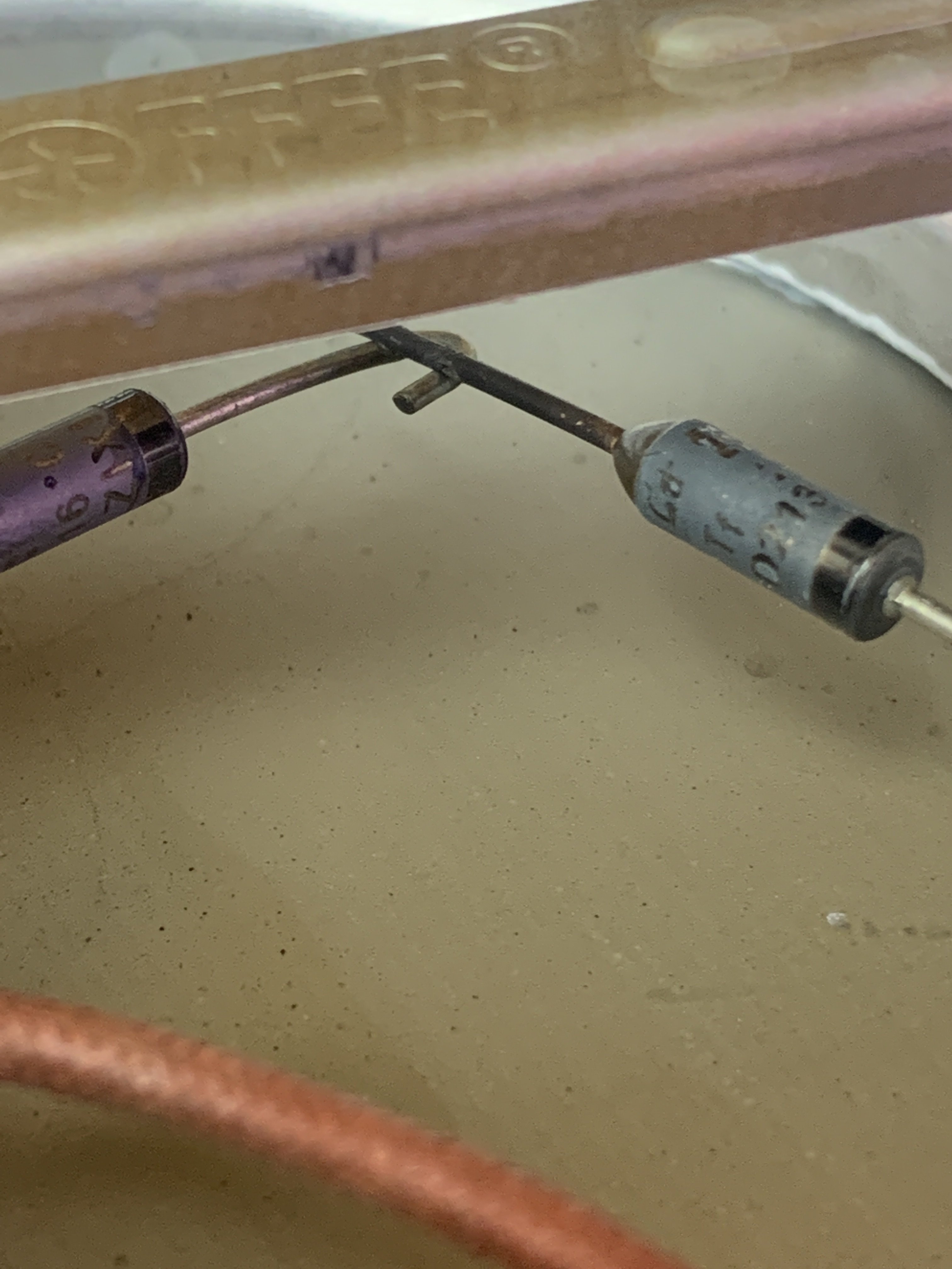

hi there, can anyone tell me what this is in the attached picture?
There are 2 of them in series that the power for the element in my coffee maker won’t go through.
Those appear to be thermal fuses. They come in various sizes and current ratings. GOOGLE
