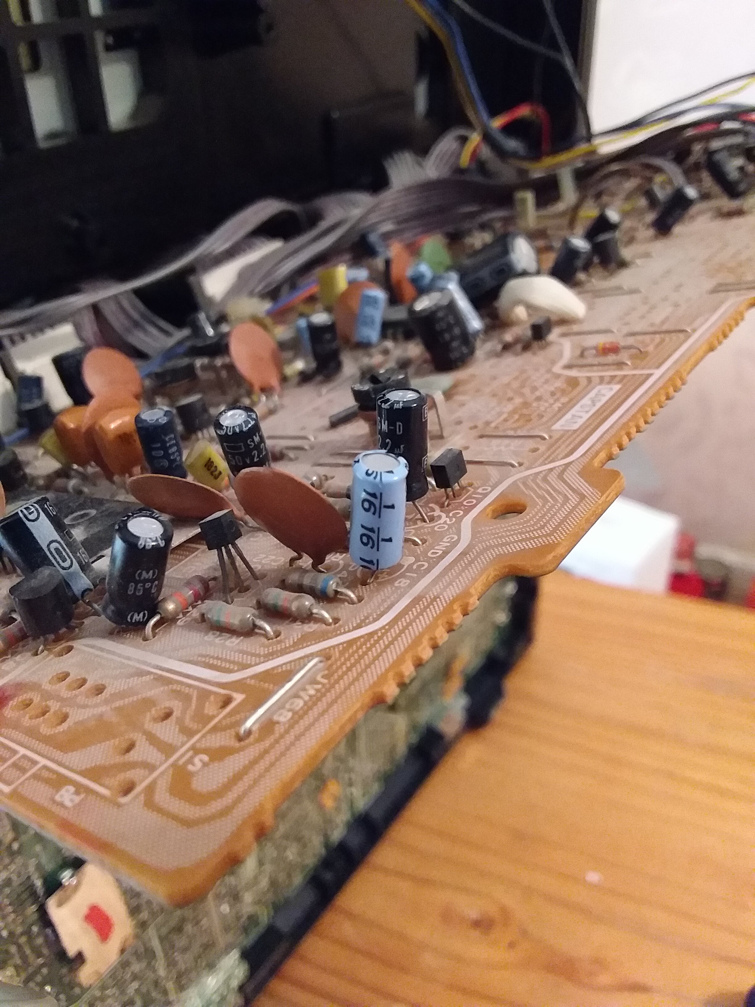

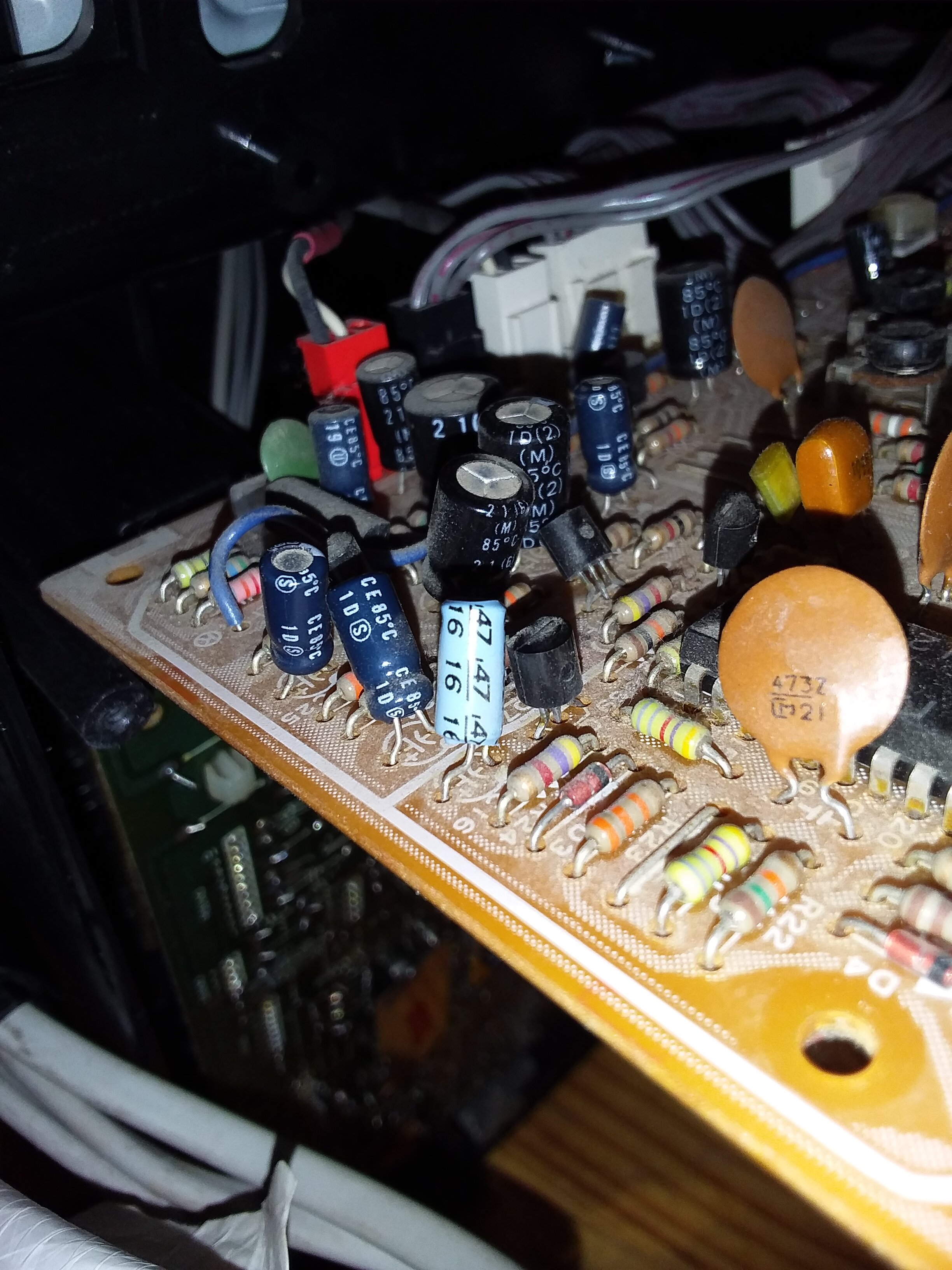

I'm trying to identify the values, in Farads, of the light blue capacitors in the following photos. These are Sanyo capacitors from the early 1980's.
This is a betamax VCR.
What does the 1/16 mean?
What does the tiny dash in front of the 47 mean?
The light blue cap at the back has a small dash, followed by 68.
Remember, it's only the light blue caps I need to identify with a view to replace.
I have no idea why the little dash is there, but I would say that they are 47uF 16v capacitors, and the one with a 68 is a 68uF 16v capacitor.
Point for seven?? just written as .47 rather than 0.47uF possibly??
It's a strange marking if it is.
1st = 1uF 16v
2nd = .47uF 16v (point 47uF)
3rd = .68uF 16v (point 68uF)
And yes that is the correct physical size for such small value electrolytic capacitors - remember, we're talking 1980's tech.
You should be able to find the schematics on the net to confirm.
OK,
having studied the pics a little more and re-considered the sizes, I agree with 1uF, 0.68uF and 0.47uF.
Digikey doesn't have any electrolytics less than 1uF. Might be safest to unsolder one of the caps and measure its value.
I'm just saying they are rare, so probably best to verify via measurement than to make a bad guess.
And depending on what part of the circuit they are in, could probably all be replaced with 1uF - remember, back then electrolytic capacitors had huge tolerances - in the 20 to 80% range (some of today's are not much better).

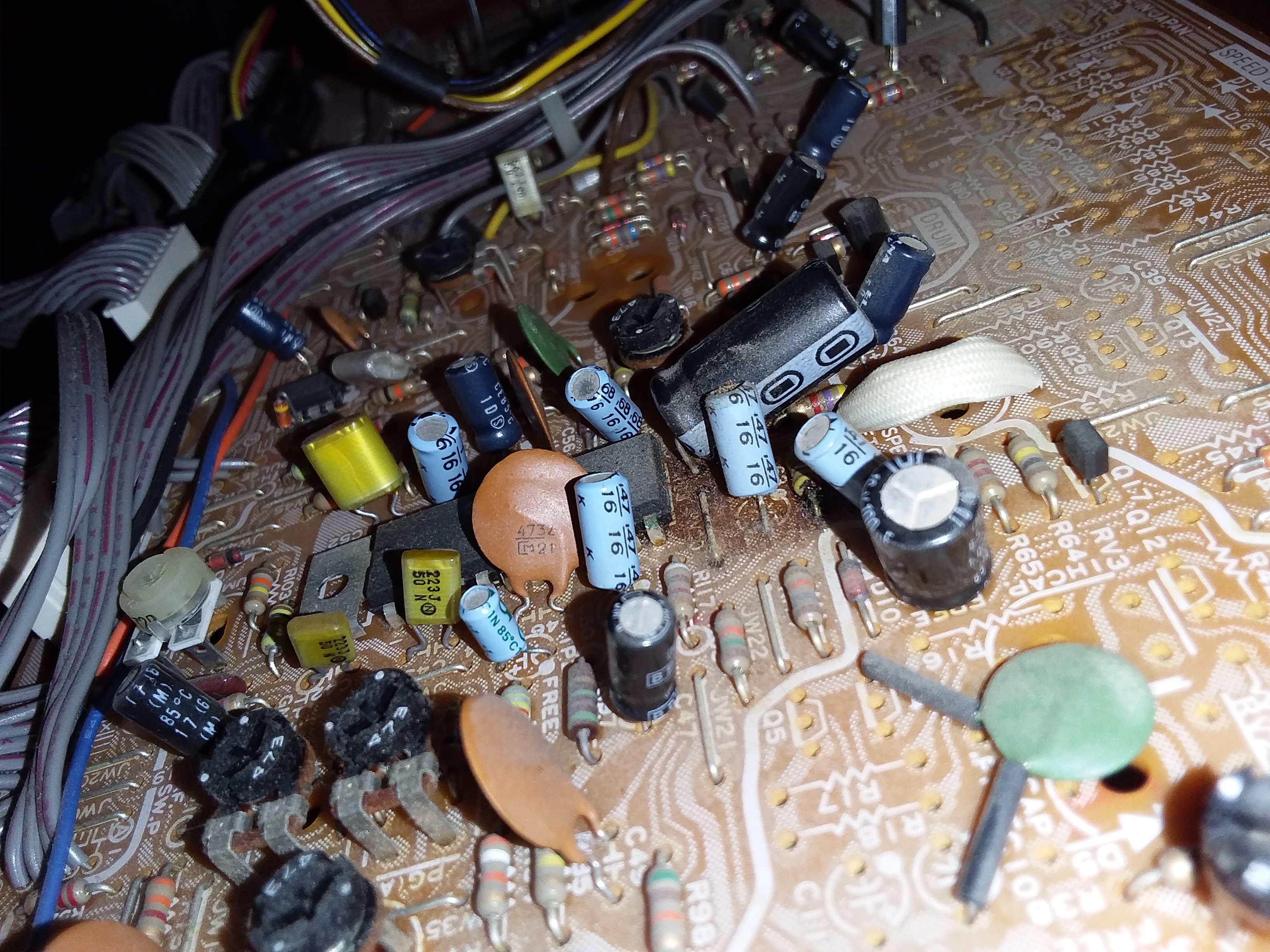

While the light blue Sanyo caps were famous for drying up, Looks like you have a bit more on your hand than Sanyo caps....
I am very familiar with that era... I can certainly spot the same thing in your posted pix
Pay close attention to the darker areas on the board as you will notice some of the Electolytics have been slowly leaking out.(mostly from the cathode lead). It makes an absolute mess. Not only it is conductive, it is also very corrosive, etching traces and capillaries up the adjacent component legs.--(watch out for the smell as you begin to de-solder). The left-over liquid could easily act like a massive resistor pad under components and you may have to pull components
Look up the series number on the leaky cap and if there are used elsewhere on the board, it is just a matter of time before they will leak and make a mess. If you happen to have an odd servo &/or video problem, it can easily send you thru a wild goose chase.
