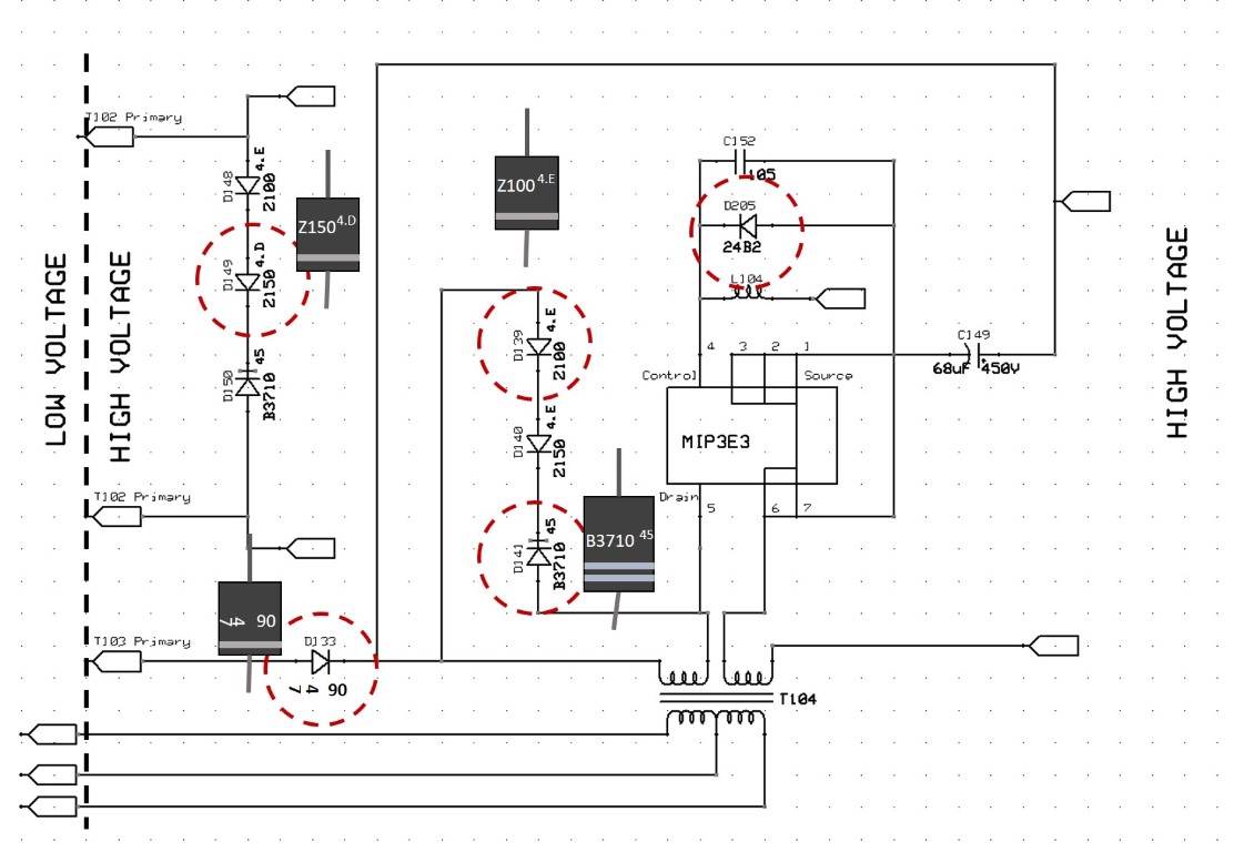

Does anyone know where I can find a schematic of the PSU board (AXY1083), or can anyone help identify the following through-hole diodes, or suitable substitutes?
Diode D141: plastic, marked with a double cathode band and "B3710", then in smaller numbers "45".

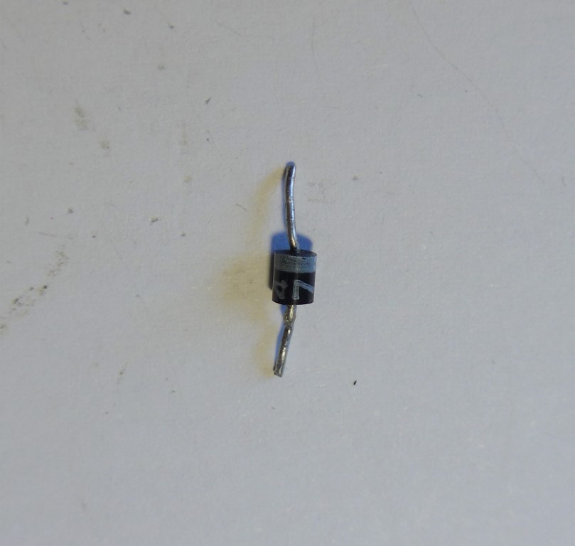

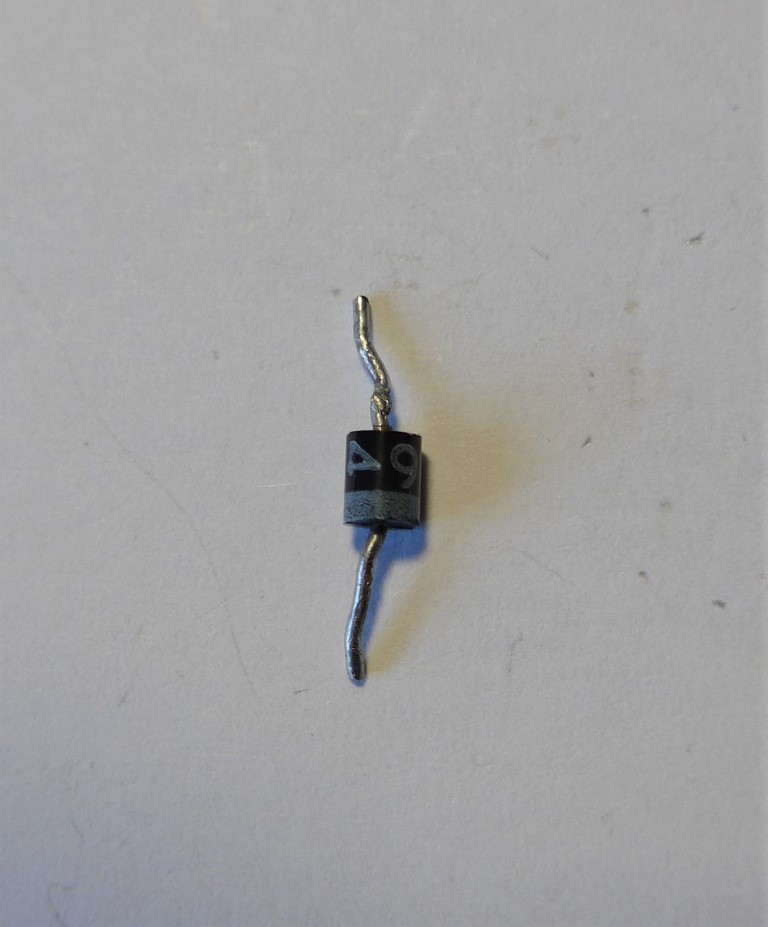

Diode D133: plastic, marked "06" along the body, then "47" at right-angles i.e. around the body. Or if I read it upside down, the first numbers could be "90".
Diode D205: glass, marked 24B2. I think this is a 24V 1/2W Zener - can I use a 24V 1W zener (e.g. 1N4749) to replace it ?
Diode D149: plastic, marked "Z150 4.D" - is this a 150V 1W Zener?
Diode D139: epoxy, marked "Z100 4.1", is this a 100V 1W Zener?

Here's a schematic of the area in question (best I could do by following the tracks on the 2-sided board!) with the faulty components circled, and I've also included mockups of the body markings. There are other connections to T104 windings that I haven't been able to trace yet.

I'm more inclined to agree with your zener diode theory now I've seen the schema. Though if that is the case they are doing something unusual because there's no limiting resistor. I guess this is where the "specialness" of the others comes in.
Maybe look at standard designs for switch mode supplies for clues. I know very little about them.
Where you've shown diode symbols with 2 cathodes lines, is that the actual marking on the board or is it your own invention?

The two cathode lines on the schema were my invention merely to remind me about the double band.
Assuming Z100 is a 100V zener and Z150 is a 150V zener (which Google indicates they might be), from looking at various other switchmode schemas, I think the these two in series will be equivalent to a single 250V zener, and put back-to-back with the B3710 across the transformer primary, this combination probably makes a surge protector/transient killer. And while a bit charred by the blast from the melted IC pin, these all seem to test OK on the DMM, with voltage drop across each of them (at 9v, 25mA) 0.79V - same as the good ones elsewhere on the board. So I may just put these all back in and hope for the best.

You have mis-traced your schematic. Showing D139, D140, D141 and T104 winding all in a closed loop! If you found that part by tracing with dmm perhaps it's indicating a short?
The voltage of D205 probably has something to do with the relative level of the source and drain voltages, and the signal coming in via L104. Does look an odd arrangement though.
As to D133, can you post a photo? If it's a funny shape/colour it's more likely to be an ultrafast recovery diode. Can you post a photo (you can attach direct to post, it's easier for respondents than following a link) of that one? Markings don't usually do something silly, so with the "4" the right way up the rest should make sense. The 4 and the 7 are likely to follow the other two digits rather than come before. They could be some code that isn't part of the part number (like a date code or batch number).

Re the schematic - there are other connections to the T104 winding from other parts of the board, but I haven't managed to trace them yet. The diodes sit in parallel with the winding (like T102) which is why they looked to me like surge/back EMF/transient suppressors.

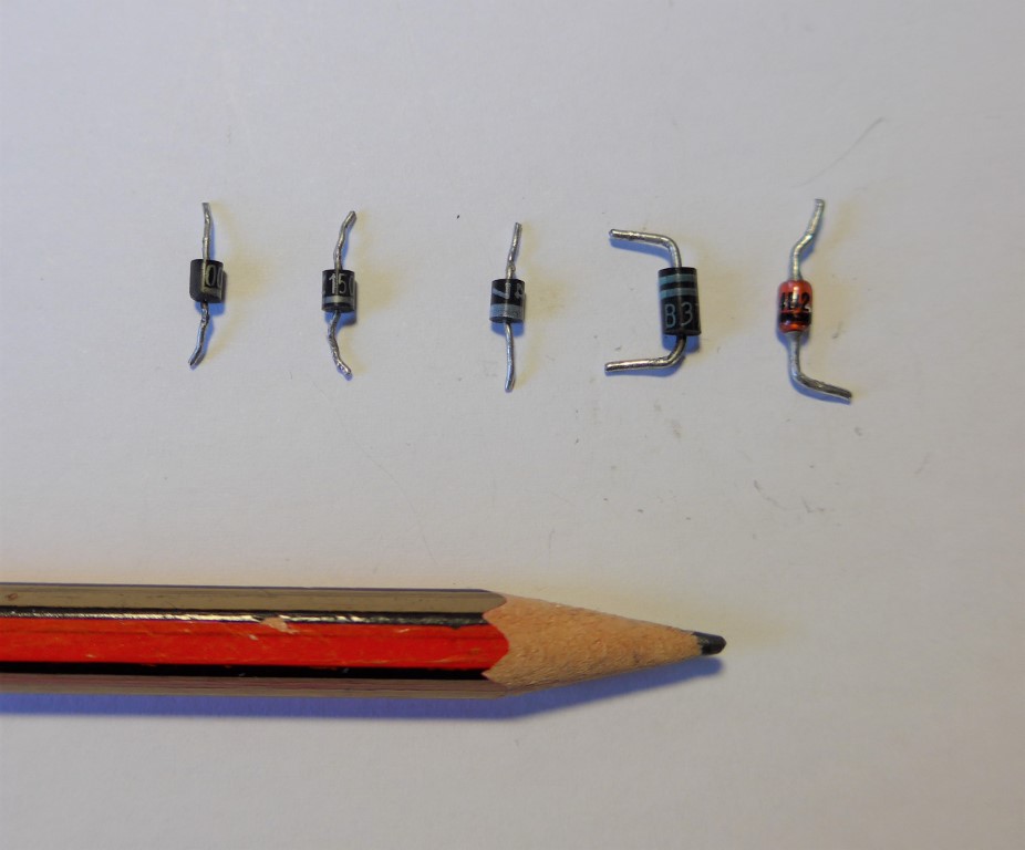

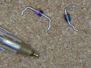

Below are thumbnails of the diodes, showing (left to right) Z100 (D139), Z150 (D149), 74-90 (D133), B3710 (D141) and 24B2 (D205).

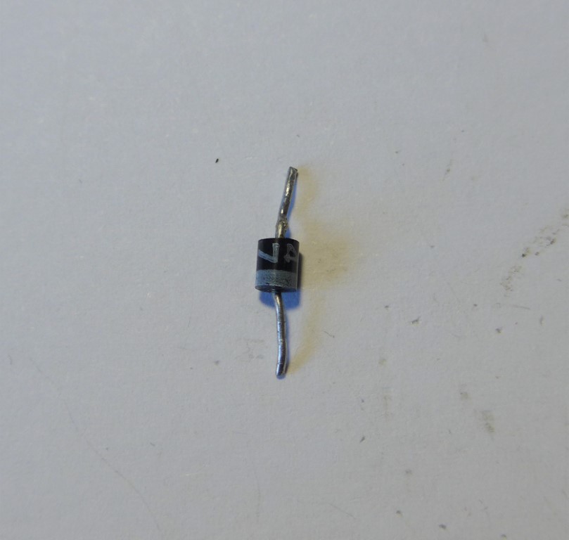

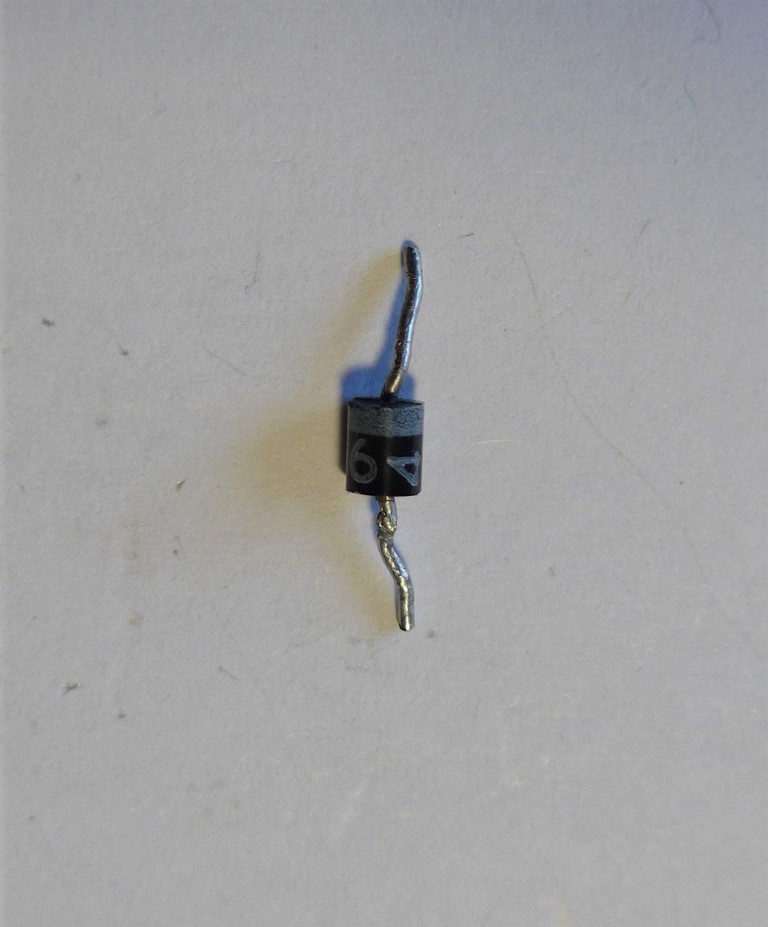

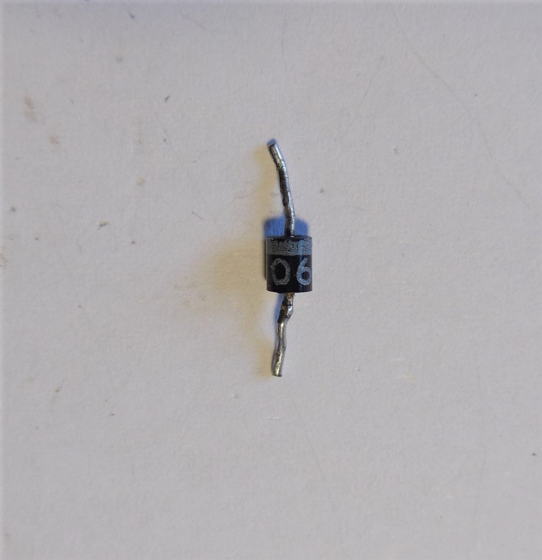

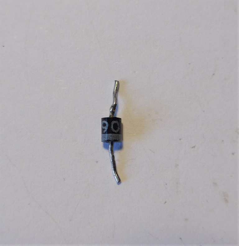

The next three photos show D133's markings, cathode at the bottom, rotating the body left-to-right.
And here's the same, with cathode at the top in case it makes more sense that way round. I can't make head nor tail of it! Hope someone can.

I'm becoming more convinced that that Z100 and Z150are probably 100V and 150V zeners but I don't have a 100-200V current-limited supply to test them with. And I think B3710 is likely to be either a 200V zener or TVS. Anyway, as they all seem to test OK, I can try putting them back in (or replacing with similar ones) and see how it goes - can't be any more broken than it is at the moment!

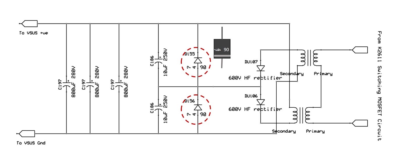

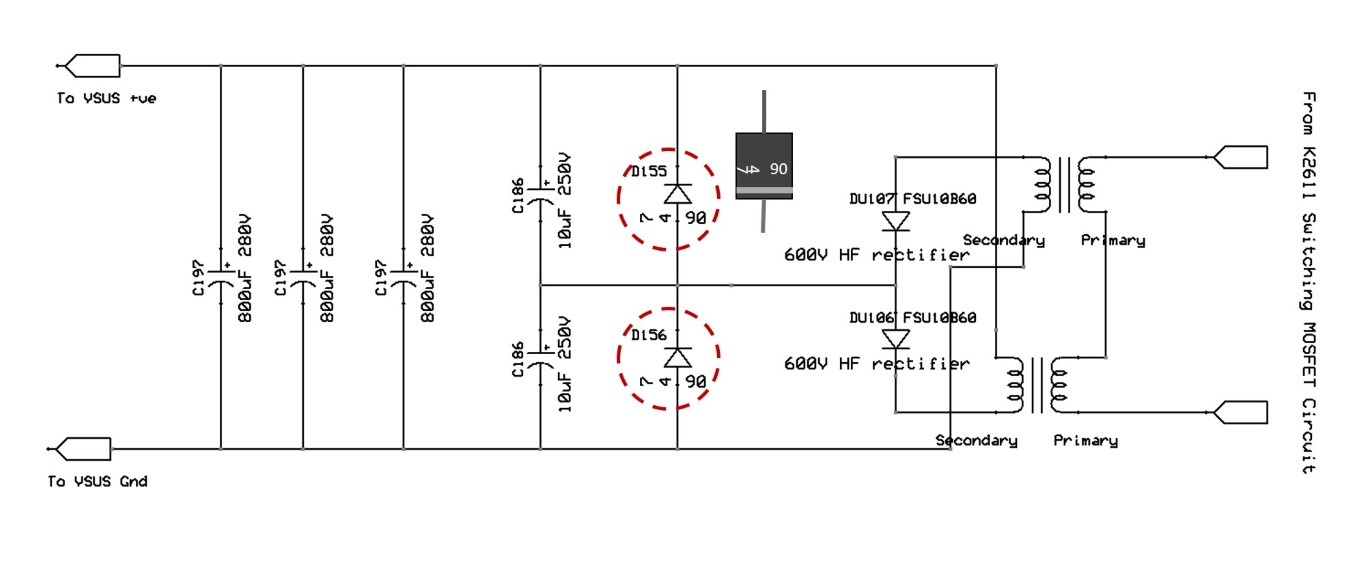

D133 (the one with the funny "74-90" markings, which is shorted) is the one I'm having most trouble identifying. There are two others of these on the board, in the rectification area for the VSUS voltage, which I think from research is typically around 200V or greater. In the schematic below (best I could do from tracing the board), DU106 and DU107 are heatsinked FSU10B60 - 600V 10A high frequency rectifiers, like this:
Each of the "74-90" diodes (D155 & D156) sits in parallel with a 10uF 250V electrolytic, as per the schematic below (best I could do from tracing the board).
From their small physical size and where they're located, I'm thinking they are most likely high voltage ultra-fast recovery diodes, something like SF28 (600V 2A ultrafast) or MUR460 (600V 4A Ultrafast), rather than zeners, TVS or Schottky. Or they could just be good old 1N4006 rectifiers, which would be good as I have a lot of those already!
Any thoughts?

Pretty sure after looking at your photo again it's 47 and 06. That ambiguous digit looks wrong if you try to read it as a 9. I think it's a mistake to try to read it as all one figure, that's why they changed the orientation of the 2 parts.
Don't need a constant current supply, just a limiting resistor. If you are prepared to deal with a live circuit you can rectify and smooth mains voltage and connect a series resistor lets say 22k to 47k with the diode. connect your volt meter and turn the mains on. Don't need to touch anything. You can even do it all with "chocolate block" connectors.
You really need to start putting connection dots on your schematics! The one you've provided here looks quite a bit different from the first one you posted. Am I correct thinking this is a different section?

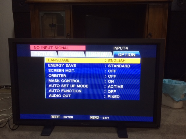

I replaced the blown MIP3E3 IC, reinstalled the diodes that were charred but still appeared to be working, replaced the blown D205 with a 24V 1W zener and D133 with a MUR460 (about 4x the size and I had to drill the PCB holes out to 1.5mm to accommodate the leads). Checked the transformers and MOSFETs for shorts - all seemed OK. Put it all back together and powered up, half expecting a bang and a puff of smoke, but Bingo!
Will run it for a while and check temperatures etc, but all seems OK for now.
