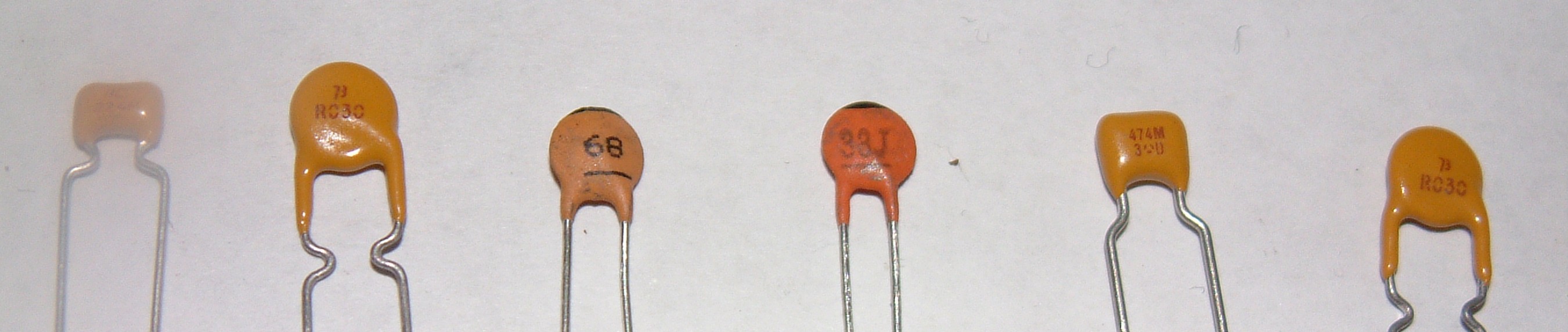

Hi, can you help identify these compnents - i was sorting out some bits last night and this is what i came up with. Im very impressed with the camera - as I noticed some number on the components that i couldnt see with my eyes :eek:
Attachment A - from left to right
says 224M - is that = 220nF
says R030 - no idea on this either
says 68, has an underline and the tip has been dipped in black - no idea if its µ, n or p. = 68pF ??
says 33J, underline and black tip also = 33pF ??
says 474M - is that = 470nF

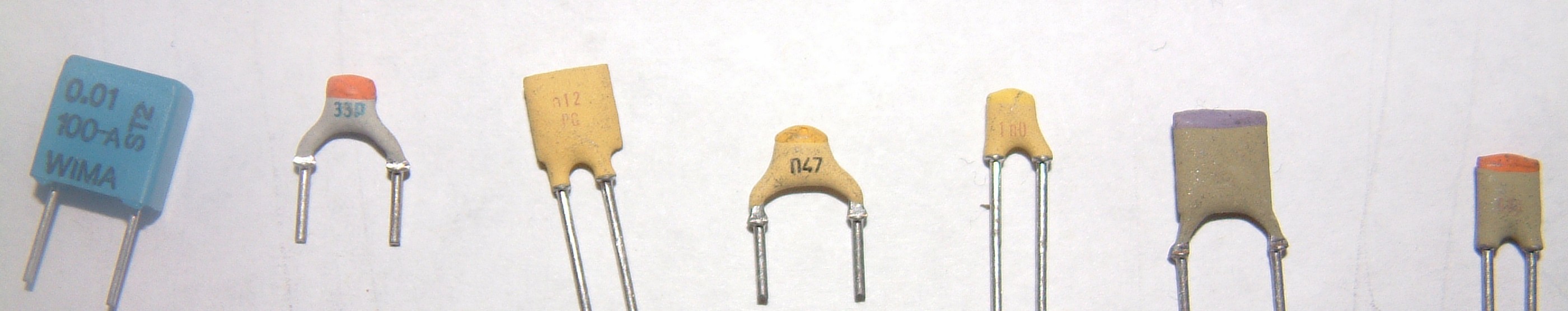

Attachment B - from left to right
0.01uF ?? what type of cap is this
33pF
says n12, so is that 0.12nF = 120pF
says n47, so is that 0.47nF = 470pF
says 1n0, is that 1nF
after looking at the pics i realisised the camera was picking up much more than i could see - this ones says n22 in tiny grey writing on the back - as above n22 = 220pF
this has what looks like 68µ is that possible for such a small cap?

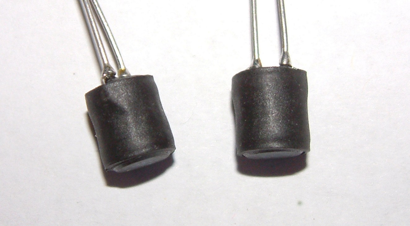

Attachment D
I think these are inductors - appears to be a winding capped with that black metal you get in transformers (ferrite??)
one says 683, is this like the capacitors codes - eg 68000 and what is it measured in, eg is this 68uH ??
the other says 153, is this 15uH?

First off, if a letter follows the value, it represents the tolerance. Here's the table:
B = ±0.1pF
C = ± 0.25pF
D = ±0.5pF
E = ±0.25%
F = ±1.0pF
G = ±2%
H = ±2.5%
J = ±5%
K = ±10%
L = ±15%
M = ±20%
N = ±30%
P = -0, +100%
S = -20, +50%
W = -0, +200%
X = -20, +40%
Z = -20, +80%
And here's a link to a tutorial on reading cap values: Twisted Pair Forum / Capacitor Nomenclature
As to your caps, here's my input based upon what I can see.
ATTACHMENT A:
1: 224M is 22+4 zeros in picofarads or 220000pF = 220nF = 0.22µF. The "M" indicates a tolerance of ±20%.
2: "R030" -- no clue what you have there
3: 68 with no other marking is 68pF; the black tip on a ceramic cap indicates an "NP0" type with a near-zero temperature coefficient
4: 33 with no other marking is 33pF; the "J" indicates a tolerance of ±5% and the black tip on the edge signifies an "NP0" capacitor.
5: 474M is therefore a 470nF, ±20% cap
6: "R030" -- ???
ATTACHMENT B:
1: 0.01µF, as written; this one also has the voltage rating: 100V
2: 33pF
3: n12 should be 0.12nF or 120pF
4: n47 should be 0.47nF or 470pF
5: 1n0 should be 1nF
6: n22 would be 0.22nF or 220pF
7: "68µ" To tell you the truth, I can't see the critters all that well in the photos, but that's a ceramic cap and it ISN'T 68µF. I'd start guessing at 68pF and work from there. I'm not big on digital cap meters for determining values*, but they are a help in zeroing-in on the marked value.

ATTACHMENT D: I forgot to make notes on those, but the little black thingies do appear to be inductors.

Thanks dean, thats great - I'll label up the the ones that youve helped with and get them off the dining table - the wife will be pleased!
That 68uF one - it is a 68pF - i went through about 30 of them with the magnifiying glass, and managed to find 2 that had the full letter 'P' - im guessing the stamping machine was running out of ink that day!
R030 is a 300mA PTC resistor (a type of automatically resettable fuse)
The attachment on the right is an inductor.
