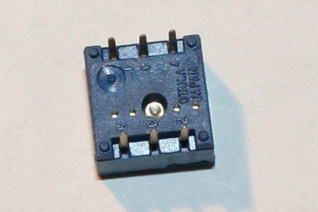

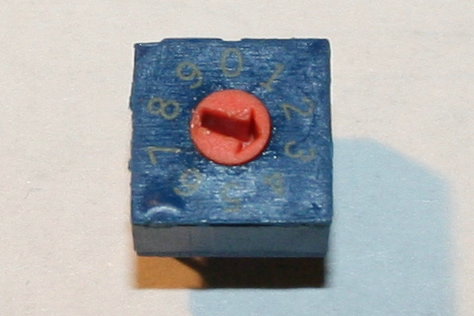

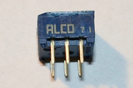

I received several of these in a box of misc. electronic parts. What are they?

PCB mounted rotary switch, which (most likely) gives a binary coded decimal output
It's a 10 position BCD (Binary Coded Decimal) switch.
position  -8-  -4-  -2-  -1-
  "0"      0    0    0    0
  "1"      0    0    0    1
  "2"      0    0    1    0
  "3"      0    0    1    1
  "4"      0    1    0    0
  "5"      0    1    0    1
  "6"      0    1    1    0
  "7"      0    1    1    1
  "8"      1    0    0    0
  "9"      1    0    0    1
<edited> to fix the "9" truth table output...
Me thinks:
"8" 1 0 0 0
"9" 1 0 0 0
"9" needs fixed:
"9" 1 0 0 1
Ron
