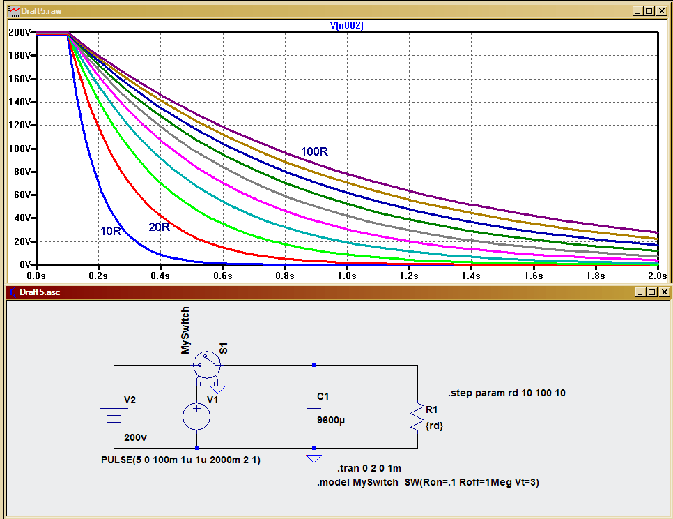

I have a 9800uf 200v capacitor in a power supply that I would like to discharge in 1 second or less. I am connecting a bleeder resistor or a series of them to the cap to discharge but I can't figure out which one to use. I know that I can only have a max resistance of 45 ohms to get the cap down to 20v in about 1 sec. Also I have 5 10 ohm 10 w ceramic resistors that I would like to use if possible. What would your recommendation be for the proper resistor or is there a way to wire the ones I have?

Look at this family of discharge curves, 10R to 100R in 10R steps.

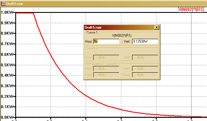

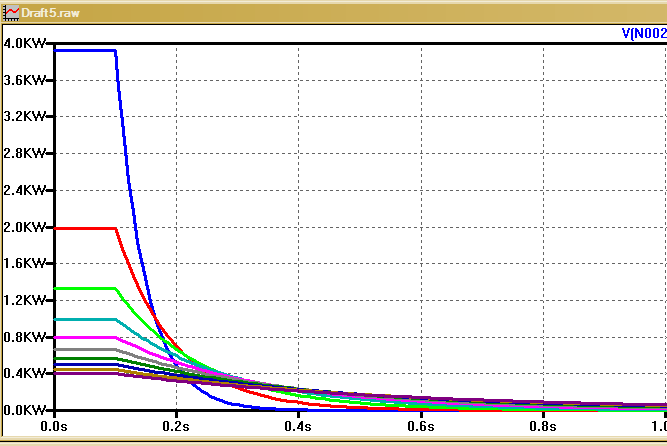

Attached the Power curves
Connect 4, 10R 10W in series

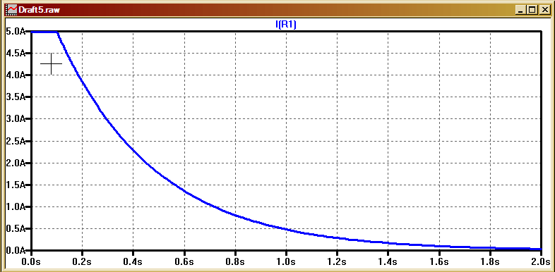

That graph just shows exactly what I posted that at about 40R the cap would be down to 20v in 1 second. This info I already know. What I am asking is how I would wire my 5 10 ohm resistors to accomplish this. I know I can put 4 in series to get 40R however I don't know if the resistors can handle the 5 amp surge at the start of the cap discharge.
So will the resistors be able to handle the 5 amp surge?
If not can you recommend the part number or specs of a resistor that will be able to safely discharge the cap without failing?
Are you attempting to short out the cap to work on the circuit or as a permanent safety discharge feature? If the latter, one normally expects to see a value much higher value of resistance that will drain the supply at a much slower rate (like about 5% to 10% of the power supply’s rated current) taken directly to ground. That is why one will normally give a power supply 30 to 60 seconds after removing power before touching it.
If the former, then the size is relatively unimportant because heat is generated for such a short time (about .7 second in your case). While a 5 watt rated resister is required if it was permanently connected, you can probably get away using a half watt resister since you will probably want to use some type of handle that will also dissipate some of the heat.
