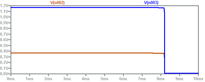

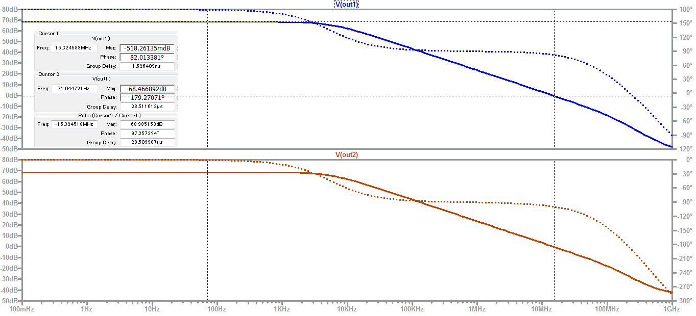

Dear all,
ok Now I have some grasp on CMFB Design, the AC response looks good (may be). But my opamp doesnot work during transient simulation. Can you guys help me with that.
I have uploaded the schematics, model file, and png files for output of AC and transient responses.
please help.
gopal
you spec ±1.8V and you optimistically supply it with ±900mV
you don't step the voltage source at startup = your amp may take up to 10-s of seconds to initialize itself to normal operational state (especially when using ideal power sources and perfect biasing (a reverse diode or 2 in series to rail from any of the outputs may cancel the least))
also if there's not enough power to drive the output (an output stage design malady) then your AC may pass but the transient is externally set by biasing resistors effect on outputs -- don't put anything at outputs differ/alternate slightly the inputs by ±(5...2000)µV to see if the outputs swing at all
