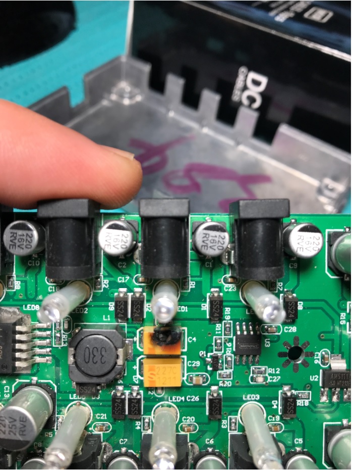

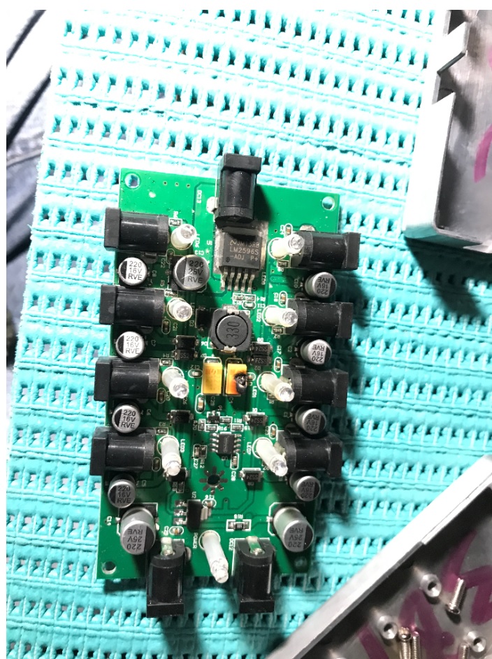

hello could you help me or tell me that capacitor is this one that is melted, I don't get the schematic, but apparently it is the same
the capacitor below has written 227c 1211
this ist a mxr dc brick m237 but i cant find the schematic

227 sounds like 220uF, like these:
It is good to hear a success story.
Thank you Eduardo.
