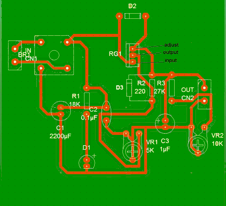

i recheck the connection and the compenents . everything is ok and nothing exploded except POT 5K .
and this is the PCB, please check it for me . may be my brain wasn't with me.
i think the wrong thing i've done is to add D2 in parallel with R2 (in the same hole on PCB)
so please help some one in trouble.

You might want to look at the pinout for the LM317 here on the datasheet.
https://www.electro-tech-online.com/custompdfs/2010/08/LM317.pdf
Note that with the tab down pin #1 (left) is the adjust, pin #2 (center) is the output and pin #3 (right) is the input. With that pinout and if the silkscreen on your PBC indicates the way you placed the regulator on the board, then the adj, pin #1, is going to the bridge instead of the input, the output, pin #2, is tied to the adjust circuit and the input, pin #3, is going to the output.
here is a detailed view
i think i replace between the adj pin and out pin (hope some one tell me i'm wrong, but pcb wizard cheat me and i was sleepy to do this mistake confused)
and D1------------> LED
D2------------> between input and output.(in right way)
D3------------> in parallel with R2 (in right way)( ithink i'll remove it as no need)
now after all this i think i'll build nuclear reactor.
Now you have the pins of the LM317 labelled wrong. Why don't you copy the pins shown in the datasheet?
You show an ADJ pin is connected to the output connector.
You show an OUT pin is connected to VR1.
The datasheet says that your D3 is not needed because the capacitor that it protects against is not there.
The datasheet also says that your D2 is not needed because the value of the output capacitor is low.

Hi there,
In your detailed view above, are we looking at the foil side (copper trace side) or the component side?
If we are seeing the foil side then the LM317 looks ok, but if we are seeing the component side then it is not connected properly. I assume the tab is to the left as drawn.
Here's the drawing with a little more contrast

Hi again,
Yes, here is a drawing that shows some changes that would change where one diode is located and the other diode turned around...
There may be other changes required too, so check this over...
He's going to have to go over the entire board and check it over carefully.
Since "D3" was backwards that would blow out the pot.
Note this drawing has color coding, gray for ground, yellow for output, blue for input.

thanks for all who helped me .
specially MrAl , audioguru and MRCecil
now i'll back every thing to its position offcource NOT anew PCB . only i'll connect IC to it right pins using some wires not solder it to pcb .
i think it will work as it supposed to do (hope that)

Be sure to check out that new drawing i had posted as that shows a few important changes. Note also that that drawing is looking at the board from the FOIL SIDE.
hey!
in the new drawing i think yellow is for adjustment , blue for input and red for output .
as PCB Wizard i used to draw this PCB don't have LM317 Symbol only Voltage regulator general symbol with the reference (adj) in the middle not at pin#1 so that is the mistake ( i depend on a failure prog) and didn't take into account this point so i'll turn to EAGLE (try to learn it).

To be brief, and to encapsulate the intent of my previous post to you without getting into the minutia of the diodes, which is NOT THE ROOT CAUSE OF FAILURE, as others have tried to explain, your selection of the component to place on the board you displayed does not match the pinout of the LM317 as I tried to point out followed on by MrAl's highlighted post, without being abrupt. Hopefully, you will look closely at the posts on this page and reconsider what I and MrAl have tried to convey.
