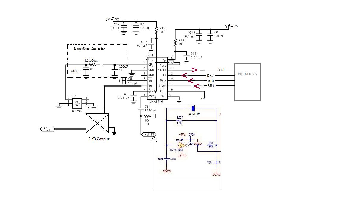

Dear all,
I have been working on PIC16F877A and LMX2306. My task is to lock the VCO frequency to 110MHz. I have designed the PLL circuit as described in LMX2306 datasheet. I have also attached my complete circuit.
I am using assembly language to program my PIC. I have also written a code based on bit-bang method. The problem is when I am sending the data bits to the PLL chip it does not lock the VCO frequency to 110MHz rather it fluctuates between 99-100 MHz all the time :(. The loop filter values were calculated from the national semicondor's tool 'EasyPLL'.
I will be really grateful if anyone could help me on this.
I have attached the code with this post and it does the following things:

Don't make your life difficult.
Do this:
1. Send the register data to the LMX PLL just once, and have the PIC waits in an infinite loop. No point sending the same data to the LMX if it doesn't lock.
2. Monitor the frequency output. Does it fluctuate between 90~100MHz?
3. If so, hardware problem. It is either the loop filter or the VCO itself. Have you determine the full frequency range of the VCO by driving it with a constant voltage?
Maybe a few suggestions what to try:
1. double-check the wiring (swapped signals etc)
2. if you have a logic analyzer, try to connect it the LE,CLK,DATA signals and compare what you see with the datasheet.
3. if you don't have a llogic analyzer try running the simulator which includes logic analyzer.
3. try use a debugger (e.g. Pickit-2) to single-step through the code.
4. if you are sure the protocol is correct try to swith to some test mode e.g. send prescaler output to Fo/LD and check it succeeds.
Petr
