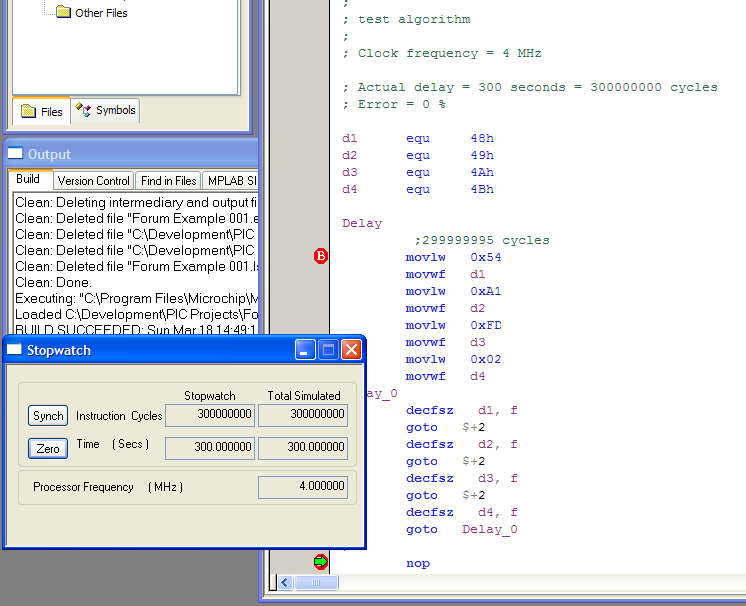

i have this code is generated by code generator software .. number of cycles in that code is 300000000 but when i calculated the number of cycles it dosenot much or approximates .... the different is a large can anyone tell me what is the wrong
Delay = 300 seconds
; Clock frequency = 4 MHz
; Actual delay = 300 seconds = 300000000 cycles
How did you calculate it?, I suspect you did it wrong!.
solidsnike said:
can you caculate it and give me the answer >>
The answers already there - 30 seconds, 0% error - it's a nested loop, and it's quite difficult to work out manually. But assuming it's from the PICList generator?, it's fully accurate as it says.
Just use the MPLAB stopwatch function. The routine is 5 usecs short of 300 seconds (the stopwatch recorded 5 usecs to my first breakpoint which was the start of the loop delay code).
Mike, some instructions are missing in your simulation?
         ;5 cycles
   goto   $+1
   goto   $+1
   nop
By the way, the code generated by the Delay Code Generator usually consider the call and the retlw instructions (4 cycles).
Yep, you're right. I didn't scroll that code window to pick up those last three instructions. Sorry.
So it seems that code block is exactly 300,000,000 cycles just like the comments say.
I agree that if the delay code is to be used as a subroutine then it should be trimmed to include 4 cycles for the call and return instructions.
Mike
Whatever you use, your own code or anything you find anywhere, it can be tested in the simulator inside MPLAB using the "stopwatch" function for an accurate counting of the elapsed time.
