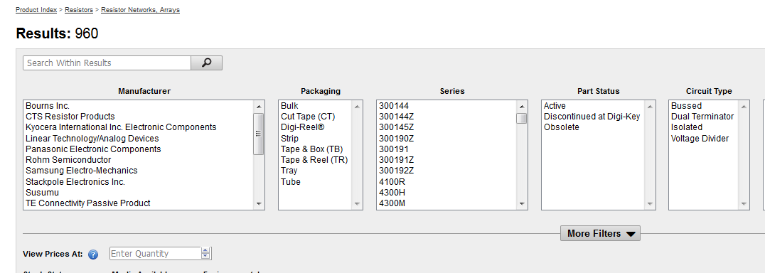

If you search on the Digikey site for: RESISTOR ARRAY, one of the filters will be CIRCUIT TYPE. That gives all the options for resistor networks available.
The only circuit type that comes up with the resistor dimensions and other filters is "isolated"
