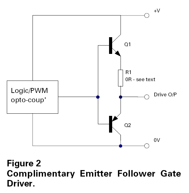

It is easiest to use a gate-driver IC.
Are you trying to drive a low-side MOSFET? Or a high-side MOSFET?
Ran into four ducks at the local supermarket, I thought they were huddling for warmth. Apparently it was three Males and a Female. They weren't huddling for warmth =O
Well, you can just use a gate driver IC. THat's the simplest and most compact solution. Or you can build one discretely.
THe simplest discrete solution is a high-side NPN BJT and a low-side PNP transistor (yes, that's right the NPN Is on the high-side and the PNP is on the low-side. This means that the transistor gradually turns off as the power MOSFET gate capacitance becomes charged and helps to prevent shoot-through currents in the gate driver).
image1-gif.27570

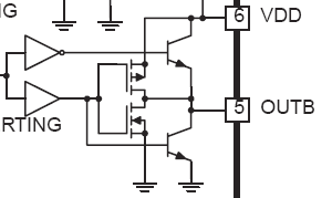

A more advanced solution is to use BJTs and MOSFETs in parallel:
image3-gif.27571
In this example they use two NPN BJTs, but you could instead replace that with a high-side NPN and low-side PNP just like the previous example (and you can remove the inverters as well if you do that).
The BJTs turn on very quickly and provide the high current pulse needed to charge or discharge the power MOSFET gate capacitance. But they can't bring the capacitance close to the rails of the gate drive supply voltage. THe MOSFETs turn on slower but can pull the gate capacitance very close to the rail voltage.
