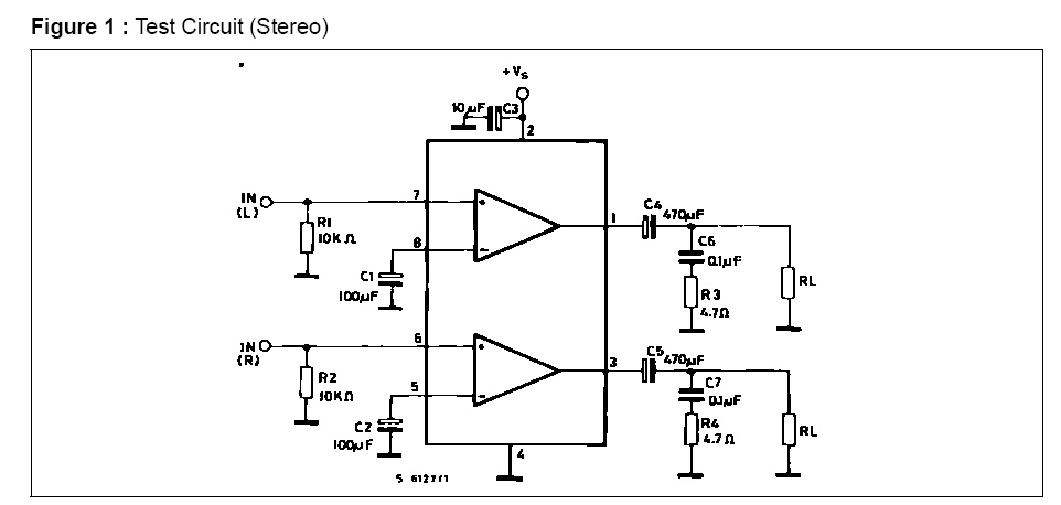

The TDA2822M will power two 8ohm speakers at 1W from a 6V supply.

Mains power isn't to be messed with by begginers, the best way to run it from wall power is using a store bought "wall-wart" transformer. These are already safety approved and will be capable of supplying up to around 12W of power. Using this you could power TDA2822M amp mentioned earlier, or even something a bit more powerful.

Search Google for the TDA2822M datasheet, it will have a schematic on it.
We googled and found "TDA2822M datasheet".
Having no background with reading this type of information we are trying to get from it what we need.
Can you provide a list of items that we would need (volume control, amp, speakers, etc.) and a basic diagram of how these items would connect?

From the datasheet http://www.datasheetcatalog.com/datasheets_pdf/T/D/A/2/TDA2822M.shtml
you should look at the attached image for a typical application.
Where you see a box, this is a resistor. 4 resistors are required. 2 are labelled 10kohm, and two 4.7ohm. RL refers to the speaker, which should be an 8ohm load (impedance is written on the back of the speaker driver).
We don't know where you are, you should fill out your location then we can suggest where to buy the parts from.
This site may help you figure out what the other symbols are, they are using the old zig-zag resistor symbol, a box is the modern symbol but both are the same thing.

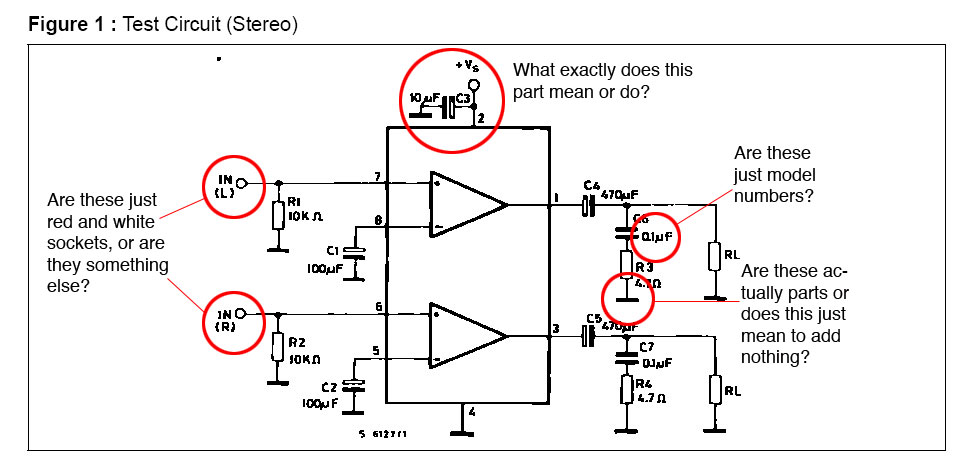

If it is OK, my son is making notes on the diagram that you passed along so that he can ask some questions.
Again thank for sticking with us so far. This is something we (he) would like to learn.
Hello, I have attached a file with a couple of questions about the diagram, could you help me out?
