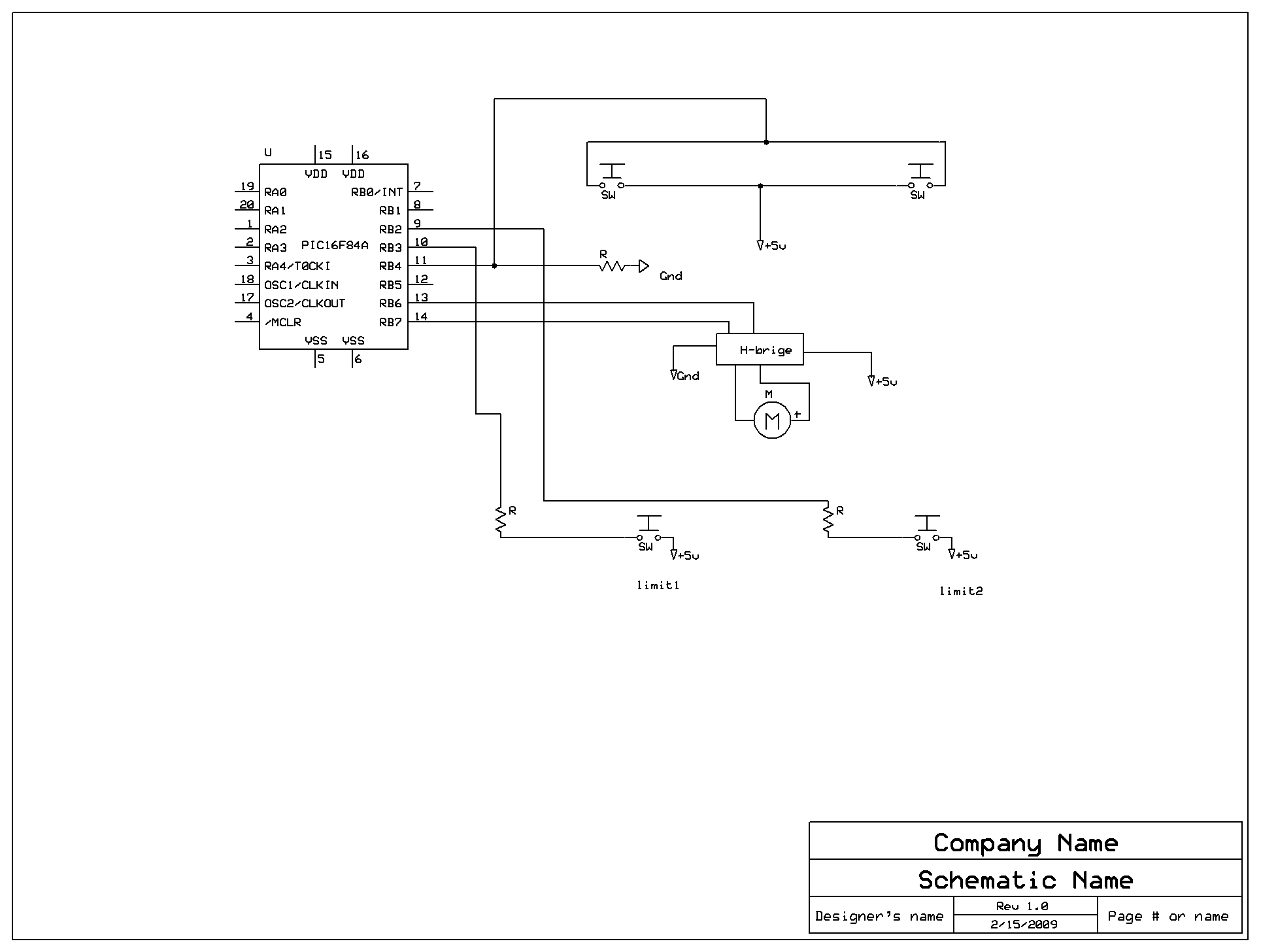

alalbeet Do you have a wiring diagram of how you want this to work. and you still need to
;;comment your code to let people no what your thinking is going to happen. I'll write a code to read the button and 2 limit switches and let's see what we can make it do.
Take a look at this alalbeet
In LOOP2
switch RB1 turn on/off (4cycs On 2cycs Off) many time, so it just give you about %70 of power so your motor speed downto %70 as normal.
speed should the same as open, if you move label LOOP2 down to line
LOOP2     BTFSS PORTB,7
In LOOP2
LOOP2     BTFSS PORTB,7
thank you all for your replying
thank you me dear friend five0 very very very much the program now is ok
