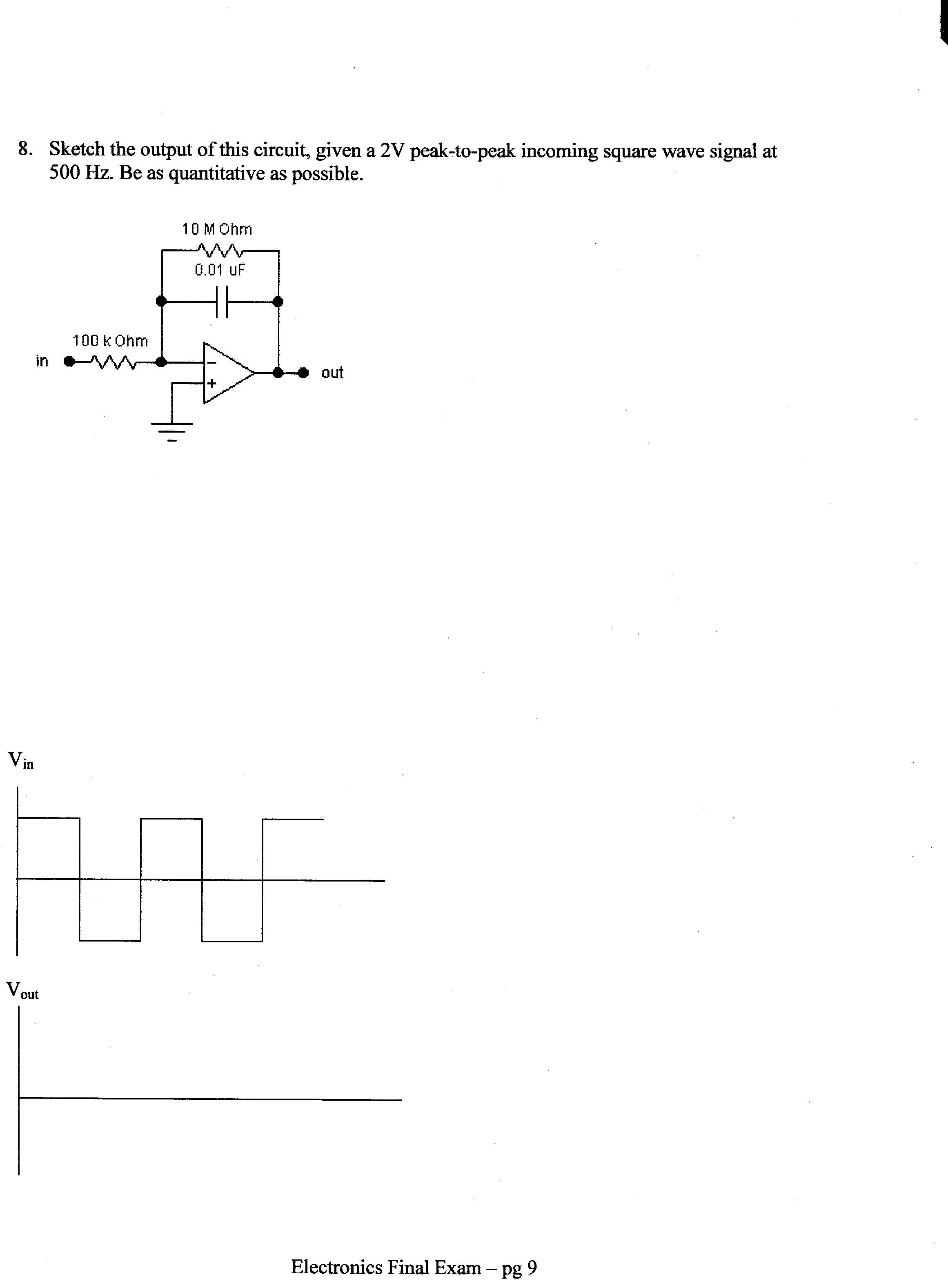

Someone please help me!! I'm looking for help on finding these solutions for my class.

Heres a little help so you can understand the problems and help you solve them yourself.
8 ) This is a filter. The gain of the filter is -(Feedback impedance)/Input impedance. At low freq, Reactance of cap(1/2*pi*FC) is high, so all current goes through the smaller 10M, hence gain = -10M/100k. At high freq, reactance of cap is low so Gain becomes - Reactance/100k. As freq increases Reactance decreases, so Gain gets smaller. It passes low freq, and not high freq. The freq at which it cuts off is 1/(2*pi*10M*0.01uf). Multiply your input 2V by the Gain at the freq your interested in, and you'll get the output waveform.

8. Assume the amp has very high gain.
Thus Vout = Zf/R Vin.
If you have learnt Laplace Transforms, then use them otherwise use calculus.
