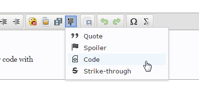

Ok, couple of things.
1) There are code tags for a reason. Surround your code with code tags to keep the formatting. It's very difficult to read without the proper spacing:
2) You need to tell us what problems you're running into. If something isn't correct, the compiler will tell you where the error is, and generally tell you what it is. What does it say when you compile it?
3) You need to tell us what you've already tried to fix the problem.
4) You need to tell us exactly what you expect it to do. There are many types of LED chasers, so you need to be more specific.
If you expect help, you need to give us more information first. Help us help you.
Regards,
Matt
