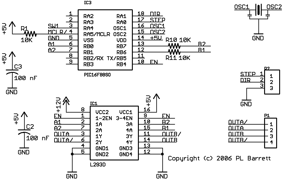

A motor like that (12V printer stepper) probably doesn't draw that much current. I have successfully driven printer steppers with an L293D and a small pic (you need 2 inputs and 5 outputs at the worst case). Here is the bare-bones schematic. parts cost new is about $6 though you can use a cheaper pic than the F88 that I used as long as it has 7 I/O pins available.
You can cut the pin count by 2 pins if you invert the A1 and B1 outputs (via transistors) to get A2 and B2 but you can't do half stepping then. then you could use an 8 pin PIC.

Thanks, philba. Can you give more info to me about this because I am a newbies and not so understand about the schmeatic that you have provide? May I know is what is P2 in your circuit diagram, is it another IC or L293D? Thanks Philba. :)
