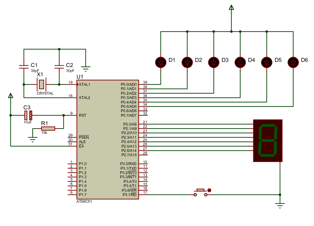

Hi good evening everybody...
I have circuit and i want to change some connection in this circuit.......
My recomedation is as follows
When the Dispaly is 0, only the LED 1 ON
When the Dispaly is 1, the LED 1 and 2 ON
When the Dispaly is 2, the LED 1,2 and 3 ON
When the Dispaly is 3, the LED 1,2,3 and 4 ON
When the Dispaly is 4, the LED 1,2,3,4 and 5 ON
When the Dispaly is 5, the LED 1,2,3,5 and 6 ON
and again the Dispaly is 0, only the LED 1 ON
I am not familier to programe or write the code....
So i need a help from somebody
Please help me and thank you everybody
Hope a god hand on my work....

You just need to create another table to store the LED data.
DB 1, 3, 7, 15, 31, 63
Then do the same to access each element. Each of these will bring on the correct number of LED's
Each time the button is pressed Increase R0.. When it equals 6 then reset it to zero.. R0 can be used to access the digit table AND the LED table...

But i dont know to write the code.....I get this from web...can you help me to write the code?

what the change may i do in this code?

START:
		MOV		R0,#00H
		MOV		P0,#0FEH
		MOV		P2,#3FH 		; initial display count 0
MAIN:	MOV		DPTR,#DIGITTABLE
		JB		P3.7,MAIN
		INC		R0
		CJNE		R0,#6,PASS		; switch press 6 then reset display to 0
		MOV		R0,#00H
PASS:	MOV		A,R0
		MOV		B,A
		MOVC	A,@A+DPTR
		MOV		P2,A
		MOV		A,B
		MOV		DPTR,#LEDTABLE
		MOVC	A,@A+DPTR
		MOV		P0,A
		LCALL	DELAY100
		LJMP		MAIN
DELAY100:	MOV		R4,#50
DELAY10:	LCALL		DELAY
		DJNZ		R4,DELAY10
		RET
DELAY:	MOV		R5,#20
D1:		MOV		R6,#250
		DJNZ		R6,$
		DJNZ		R5,D1
		RET
DIGITTABLE: 	DB 		3FH,06H,5BH,4FH,66H
		        DB		6DH,7DH,07H,7FH,6FH
LEDTABLE:	DB		0FEH,0FCH,0F8H,0F0H,0E0H
		END
I had to invert the LED table as I'm sinking the LED's instead.

when i burn chips, a message will appear....what it does mean?
the message is
Error:
Address:0
Buffer: 78
Device: ff
Is it any programe error?
I really don't know... I used to use Phillips chips not Atmel... They had bootloaders in so I never had that issue...
What program software and what hardware are you using?
I am using the Atmel Chip. The programer I am used in this company...(Please check this link below)
and I am using the software for simulation......
First I simulate in proteus 7 then use topview to again simulate. The two simulation are ok, the hardware 100% working.. In one of the simulation is not correct, the hardware maynot work.
In our proteus simulation was OK, But in Topview simulation not correct. In Topview simulation, the LED 5 not working at the time of Display 5.
when the display show 5, all LED are off (inactive). Not more error.

I hope you put current limiting resistors on the LED's
Usually, If it works on ISIS then it works for real... Did you put a pullup resistor on the button?
Hi Master
I dont use current limiting resistors on the LED's and not use pullup resistor on the button. That is the problem?

Hi Master..
The problem is in my programmer....Now i buy a new one and its working....But I dont get the correct output.
But the simulation is 100 % OK..But i build the circuit, its has some error
mean....when the 5 th LED not active when the Display shows the number 5....any idea?

Give me time to re-read the thread and find my working out.... It's been a couple of months..
Thanks to respond my request Master..
I fixed the problem and circuit is 100% correct output....Thanks.......
I did this way...
I am just add
{DIGITTABLE: DB 3FH,06H,5BH,4FH,66H
LEDTABLE: DB 0FEH,0FCH,0F8H,0F0H,0E0H,000H}
Then its clear....Thank you master.....Bye
