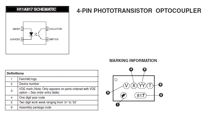

I am trying to identify and locate a replacement chip on a Combi Boiler controller PCB.
I think it may be a Fairchild component but i have had no response from them.!
It is a 4 leg/pin chip with the following markings:
V921Y
f817A
the f is like a lower case italic which makes me think it may be the Fairchild logo??
The board is in a Remeha Avanta 28C ECO combi boiler ( and no, they have not replied either!!! )
Any help really appreciated.
Rgds
Kev
OKAY Here is what I found out.
It is a Photo Transistor Optocoupler.
Fairchild Correct Part Number H11A817A
