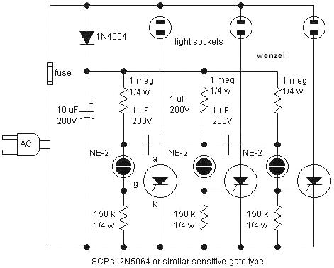

I'm kinda a novice at this circuit building. I'm trying to build a circuit to control a drag racing type start tree. I've built the timer delay as a series of cascading lm555 circuits per the third figure down in this link
Then I connected the outputs of of the lm555 to relays to drive the lights on the tree (along with some LEDs to see the circuit woking).
The circuit runs on 12VDC and the tree on 120VAC. I hooked the output of the lm555 across the coil of the relay. Then the Normally Open 'throw' of the relay connects the +120V to the light bulb, the -120V is always connected.
I know very liitle about the relays except for what they're suppose to do. The problem I'm having is the relays seem to stick on. Before I put the relays in the circuit worked perfectly lighting up the leds. Now the relays stick closed and it seems to hold the output high. Is there something I'm missing in hooking up the relays?

The relay contacts are being welded together because the relay is not rated for the voltage and/or current of the 120 volt lamps. What is the manufacturer and model number of the relay?
How many 555s do have cascaded? Are driving the relay directly from the 555? Do you have snubber/clamping diodes on the relay coils?
Is this powered from a battery or transformer? Do you have filter capacitors?
It would be a big help if you could post your actual circuit.
There are better ways to do this than using 555s. Post your circuit and the timing you want to achieve, and we will be able to help more.
As for the lamps staying on, have you disconnected the 120 Volt lamps and replaced them with either low voltage ones or LEDs?
Have you measured the relay contacts to check if they are open when the relay is released and closed when it is operated?
Have you measured the voltage across the relay coil when it is operated and again when it is released

The best way to drive a relay from the output of a 555 timer is with a diode. Anode to pin 3, cathode to relay coil, other coil lead to ground or
negative rail. Only works for coil currents up to 200Ma as this is the ratings for the 555. If the coil requires more than 200Ma then a bipolar or power mosfet will work as a driver. With multiple 555's, erratic operation can occur unless each 555 has a bypass capacitor from pin 8 to the negative rail very close to the 555.

since 120v bulbs are used, how about using triacs.

Here is the modified drawing.
