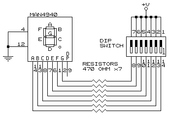

saber_holder said:
Before I start though, I want to say that I'm NOT planning on having these go or cycle in any sort of order.. They will be static, and will stay on the number I want.
Here's a simple circuit which will allow you to set the display to whatever number you want without counters, decoders, etc. I use a MAN4940 display (simply what I have on-hand) which is common cathode. If you have a different display (probably), change the pin numbers on the diagram to reflect your display's pinout. If you don't know the pinout for your displays, google the part number, you'll probably find it easily. If your displays are common anode, reverse the battery connections on the diagram.
To display whatever number you want, use the dip switches to turn on the segments you want to light. The resistors are 470 ohm and will allow about 19mA thru each segment with a 9v battery. If you want to use 2 AA cells, change the resistor value to 150 ohm (20mA). If the display is too bright, use a higher value resistor. If you use a lower value, you may damage your displays. JB
Jbeng, I think your schematic is the best idea for saber_holder. However, you neglected to account for LED forward voltage, which is nominally 2.2v at 20ma. For a 9 volt supply, a resistor of 360 ohms will give about 19ma. 3 volts seems pretty low to use on a 2.2v LED.
Ron H said:
However, you neglected to account for LED forward voltage ...
True, Ron. Thanks for pointing out my error. I do that sometimes. :oops: Last eve, I did hook up one of my 4940's with a 9 volt and a 470 ohm and even at 15 mA, it was pretty darn bright. I probably wouldn't even use the 2 AA's anyway, because a 9v is easier to connect (with it's clip contacts) and it would last a lot longer. JB
