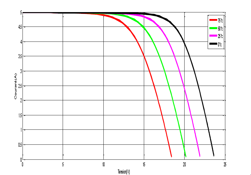

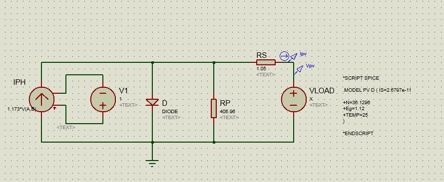

hello, can someone please help me?
i want to get the same graph it's given for different Temperature
