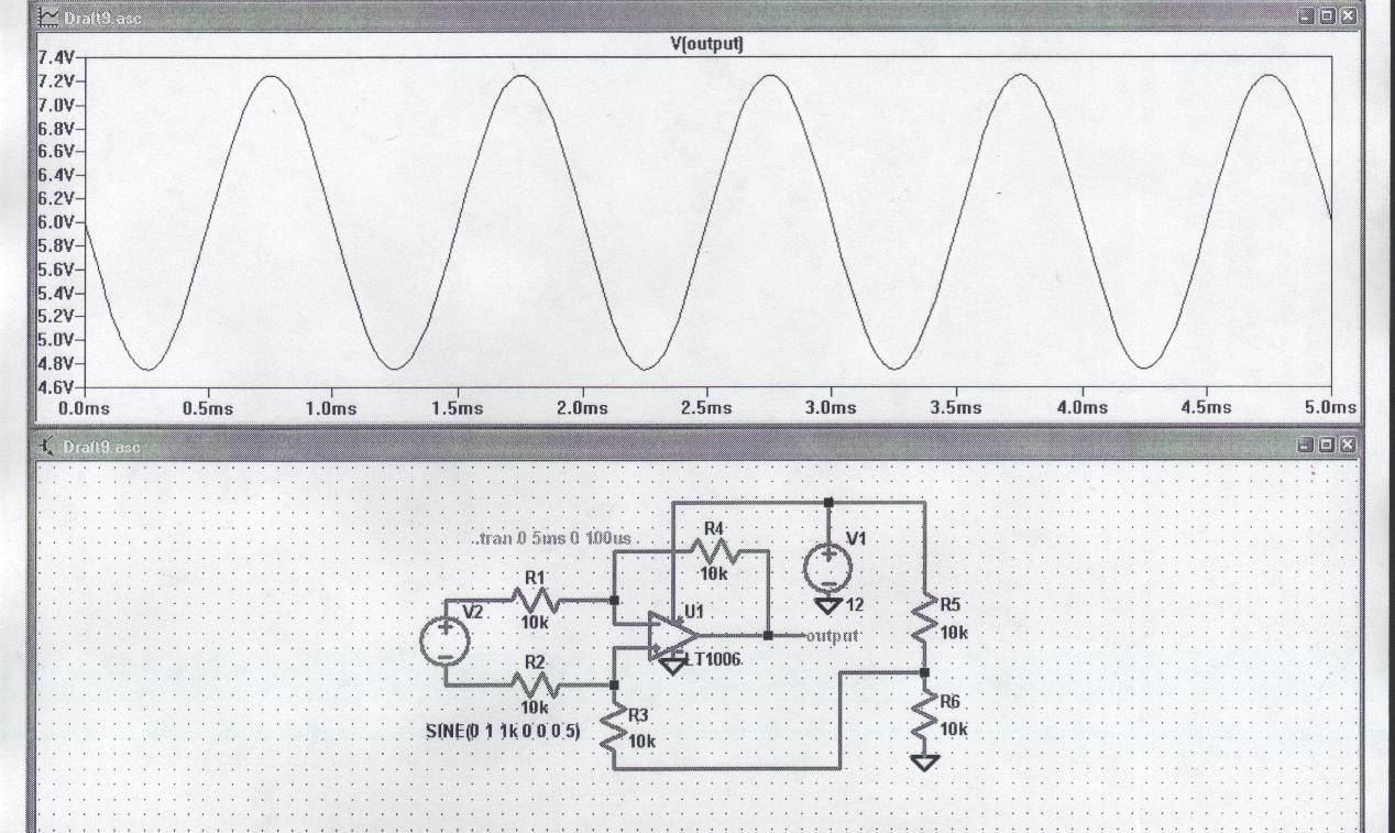

I would like to add a LED current meter to the output of a squarewave ozcillator.
I found loads of designs to display voltage, done with a row of Opamps or with the LM3915.
But how do i adopt this to meassure current?
About 8 LEDs should display 1mA to 15mA.
Supply voltage is 18V.
The output ozcillates between +/- 13V.
My thinking sor far:
I could put a resistor of upto 10 Ohm in line, which would then have upto 150mV.
But how can I feed this to an opAmp? Because the voltage of the two connections of the resistor have no relation to any other point of the circuit, I don't see how to create a reference voltage for the opAmps.

The signal out has to be somewhere between VCC and GND unless the output has a transformer, in which case there is no problem anyway. This circuit will work with a floating signal source because it does not amplify the common mode voltage. The output DC level is adjusted by the ratio of R5 - R6.

Hi Blue,
Don't you want to measure the current through the oscillator's load?
Then since the oscillator has a dual-polarity supply, isn't the load connected to ground (the connection between supplies)?
Simply put your current-measuring resistor in series with the grounded terminal of the load, and amplify its small voltage with a normal single-input opamp circuit that also has a dual-polarity supply.
Why are you using a square-wave? Most AC current measuring is done with sine-waves.
