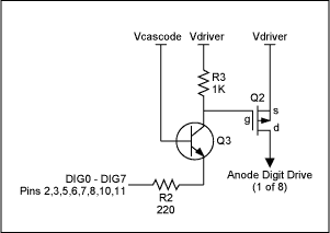

Application Note 1196 - (**broken link removed**). Since I am using 12V to power the display and the current requirement is between 25mA and 200mA per segment (most exceeding the maximum of 40mA per segment provided by the Maxim driver ICs) I need to use the circuit shown in figure 2 (see below for a copy) of the application notes for driving the digits and the circuit in figure 4 (also below) off the application notes for driving the segments.
The figure 2 schematic shows a transistor (Q3) and a PFET (Q2) but does not provide examples of the parts that should/could be used there. Figure 4 shows a transistor (Q1) which also has no part number specified. I have been searching the web for a couple of weeks now but can find no examples of this application note being put into practice. Searching through the specifications of P channel MOSFETs has not helped, primarily because I have no real understanding on how they work. I'm also afraid that if I make a mistake I may end up destroying my MAX7219/MAX7221.
So, is there anyone that could please help me work out what values of transistors and PFET I could/should be using here?

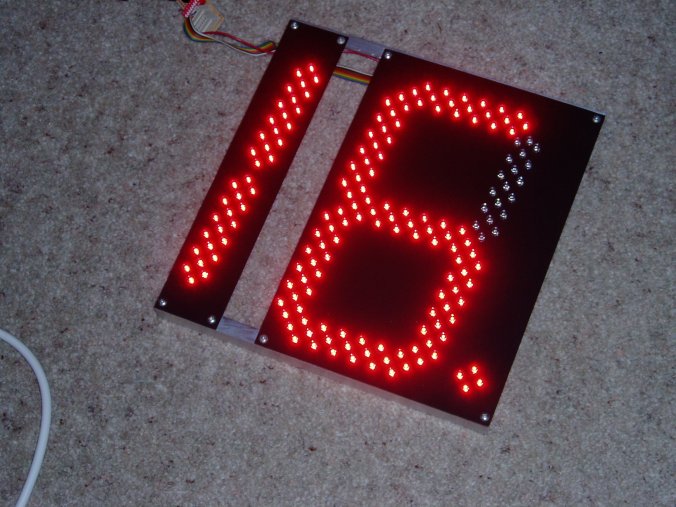

I was meaning to include a couple images of the prototype digits with my original post. They are about 10" (250mm) tall and can be easily read from 100m away with a viewing angle of about 120 degrees.
David, I'm working on a project using the MAX7219 chip also. I'm going to use P-FET FQP17P06 for Q2 and a 2N2222 for Q3.
How did your project work out and what were the final Q3/Q2 specs you came up with? Also are your LED's high brightness and specs on those. I'm going to be using 5mm High Flux LEDs from SuperBrightLEDs. IF=40ma, MCD=5500, Pulse Current at 1khz = 100ma.

I ended up going with a 2N2222A for Q3 and an IRFU9214PBF for Q2.

Thanks for the reply. Sounds like we both were on track with Q3 (2N2222). I might modify Q2 specs a little after the 1st proto. Probably size it down to around 5A. The sign I'm working on will be in direct sunlight so I need the HB leds. the besthongkong.com link was awesome. Lots of good prices for HB Leds. thanks for the link. Keep me posted and let me know how your scoreboard works out. Maybe a photo of the finished design. Good Luck.
