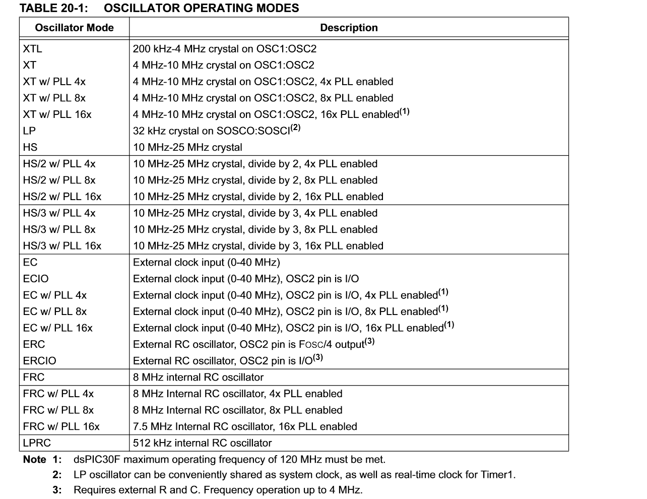

on say the 18f4685 chip, when you do the pragma setting for the OSC you can set it to use the internal OSC and have the OSC2 pin as a CLK output, so you can use a oscilloscope on the pin and you can see the internal clk frequency by x4 the oscilloscope frequency on the OSC2 pin.
i am using the 30f4013 chip and i wanted to do the same setup, but i cant seem to find how to set it, i have looked in both the datasheet and familly ref sheet and the device H file, i will post screen shots so you can see the sections and i will explain why i am confused.
first off the OSC section of the datasheet starts on page 133 and it comes under the system integration section! (took me ages to find it as i was expecting it to have it's own section!)
i should point out that at the moment i am setting fuses by the config menu in MPLAB and not by pragma directive
anyway i am using FRC setting wich gives me (approx)8Mghz internal clock, but i am convinced its not running at correct speed hence why i want to chk it using OSC2pin,

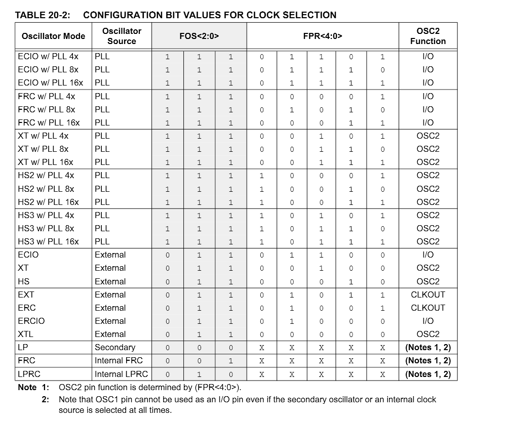

now the second pic shows the next table in the datasheet
from that you can see that for my setting it says
Note 1:
OSC2 pin function is determined by (FPR<4:0>)
now first problem i cant find FPR in the mplab watch window or under SFR in MPLAB so question 1 is how to you view how the bits are set for FPR when debugging?
AHHHHHH wait a min!! i was about to post a screen shot from the family ref sheet and from the device H file BUT, maybe i have the answer staring at me! on the table ive noticed this
ERC External RC oscillator, OSC2 pin is FOSC/4 output(3)
although i am using FRC in the H file ive noticed this under the FOSC fuses
_FOSC(CSW_ON_FSCM_OFF & FRC & ERC);
so to me it looks like i can use that setting and get internal CLK but FOSC/4 on the OSC2 pin.
now before i try this does anybody else agree with my reasoning??? reason i ask is i have already bricked one chip trying to set the fuses in software so i dont want to brick my last chip lol
