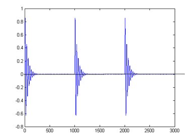

i have attached a picture of a signal... say this is the given signal... then i want to design a circuit in such a way that this circuit can tell me the fundamental frequency of the signal.... i am not using any CRO to view this signal... so my circuit should do the entire operation.
is this possible???

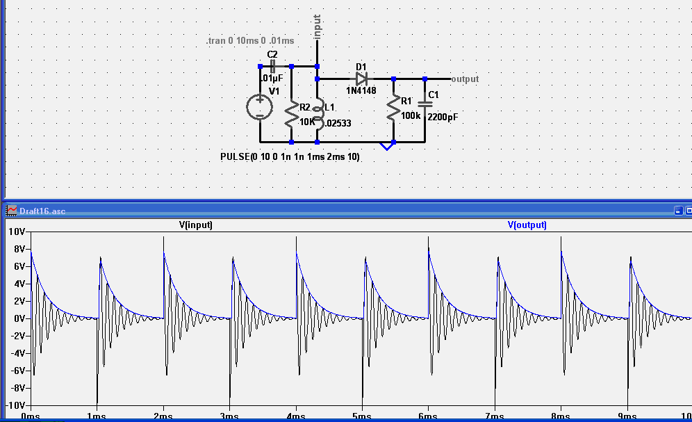

Russlk said:
If you rectify and filter, the frequency is easy to measure:
You know what they say about great minds. :D
That's the reason I asked about frequencies and amplitudes.
