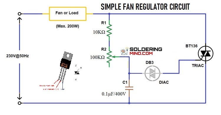

To control a 24W fan using a triac circuit, you can use a simple optocoupler-based design. This circuit can be triggered by a 240V AC signal, which is used to turn on the fan. You can use a single triac to control the fan. This write-up can give you a rough idea.
Thank you. This seems overly complex as I don't need to control speed, just simple on-off. I've seen gate signals derived from the same live as the load, just dropped through a resistor. In my case, the live signal is from a different load but the same neutral supply.

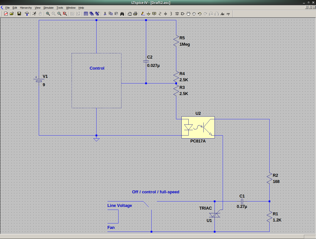

I am not sure what you need, but I sketched up this.
