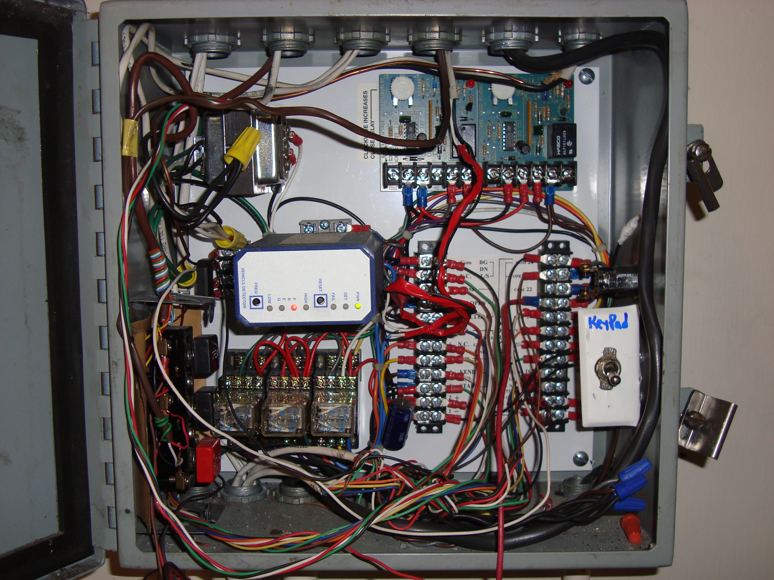

I know this is off the wall. I've been repairing overhead doors for 20+ years and have always been able to isolate and troubleshoot electrical/wiring problems. Until this week. I got saddled with a self-storage account that has very old access control technology. I can't find a manufacturer or installer, and the site manager is no help.
The roll-up doors and barrier arms are connected/synchronized through a separate "control panel". This panel is where my problem is. I have already isolated the barrier and the door and tested all functions of each independantly without issue. It's whan evverything is connected together that I am having timing problems or faults.
The concept for the system is pretty simple: keypad to open the roll-up door (goes through computer to grant access), door open limit triggers barrier to open, 2 separate timers-to-close (one for barrier, one for door) with two ground loops wired in-series as safeties. Thats the entry door. The exit door is slightly different....it has free-exit loop to open, everything else is the same.
I need some help identifying which relays control which functions in this panel. On the exit door, I managed to stumble across a missing limit switch, and...VOILA!...the barrier arm now works, the timing is correct, and no problems.
I tried to upload 3 photos of the panel in question. It didn't work. I will be glad to e-mail the photos to anyone willing to try to help. I DO HAVE a clear sketch of the wiring terminal strip labels (which are obscured by the spaghetti explosion of wires). I don't have a wiring diagram.....I think I'm gonna have to make one.
Anyone who has more to offer than, "Quit while you're ahead!" is much appreciated. I don't like giving up, but I know I'm in over my head here. If the switches are all good, then it has to be a relay problem? How do I isolate it? Should I just replace all 3 relays and hope for a miracle?
Somebody need to learn how to design a control panel. Maybe I should find a pic of one of mine. For one, the broke rule #1. DIN rail construction. Rule #2: All inputs should terminate to terminals first. Then everything ranches out. Rule #3: Use of wiring duct.
You will be surprised on just how much neater the system would be. A neater system means it's easier to troubleshoot too.

KISS, I agree 100%. This panel sucks. space is limited and the wires are hard to trace. Not to mention the 460 vac line that feeds the barrier gate runs right through this panel (how did that pass electrical inspection?).
