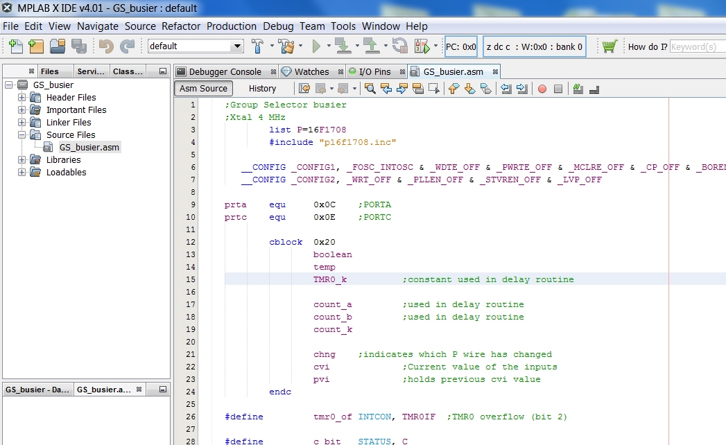

I recently downloaded MPLAB X since the PIC I'm currently using (16F1708) cannot be fully tested in MPLAB 8.92 since that PIC is not fully supported in 8.92.
I have been able to import the programme into MPLAB x, but I can't see how to test it. There is a daunting array of info available but I can't find anything relevant to answer my question.
In MPLAB 8.92, I used the function keys F7 & F9 to step through the programme so I could test it.
But with MPLAB X, I cannot find the equivalent facilities.
Any assistance will be appreciated.
Len
MPLABX is slightly different... Everything is contained within the project..
Right click the project name in the projects window... Then select properties... It should open on the correct window.
Conf: (default)... In the hardware window, swap to simulator.. From there its the same..

I did as you said, but I still can't simulate. I've tried everything I can think of to no avail. I must be missing something.
A copy of the window is attached.
When I click on the Debugger console button, the window is blank.

You need to press the debug button - the one with the green triangle. Your program will then be running, press the pause button to halt it and use F7 to single step. Or put a breakpoint on the first line.
Simulation will only be available once you build the project successfully! I notice the "Run" button is greyed out!
BUT!! I cant see the build tool on the ribbon.... Is the assembler present on the machine?
EDIT!! Whoops I'm blind.... Click the hammer tool to build..
Thanks Ian & Mike,
I took your advice & I'm was able to simulate.
I had all of the buttons at the top of the Edit window.
But when I closed the software & later re-opened it, all I have is the .asm and I can't see the Watch & Pins buttons.
I have fooled around trying to find them without success.
Please advise.
When you open MPLAB X it should be in the same state as when you closed it. I.E. with the same projects and files open. Except, it adds a start screen which you just close.

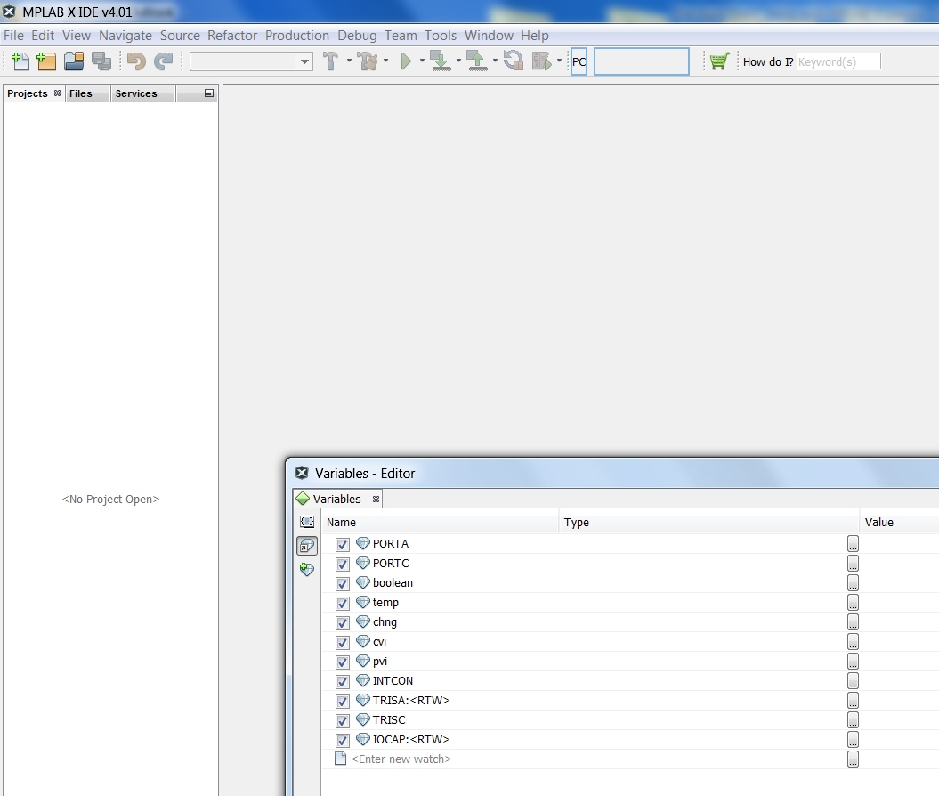

Ian,
I opened the project
Mike,
When I open it, it is essentially blank. See the attachment. I had to fool around to go back (approximately) to where I was yesterday. But I could not get back to exactly where I was.
I have V 4.01, what version do you both have? I noticed that there is a later version (V 4.01 was the latest when I downloaded) so I'm wondering if V 4.01 has some faults.
I find it extremely frustrating. So I'm considering going to the later or to the previous version.
Thanks for your help.

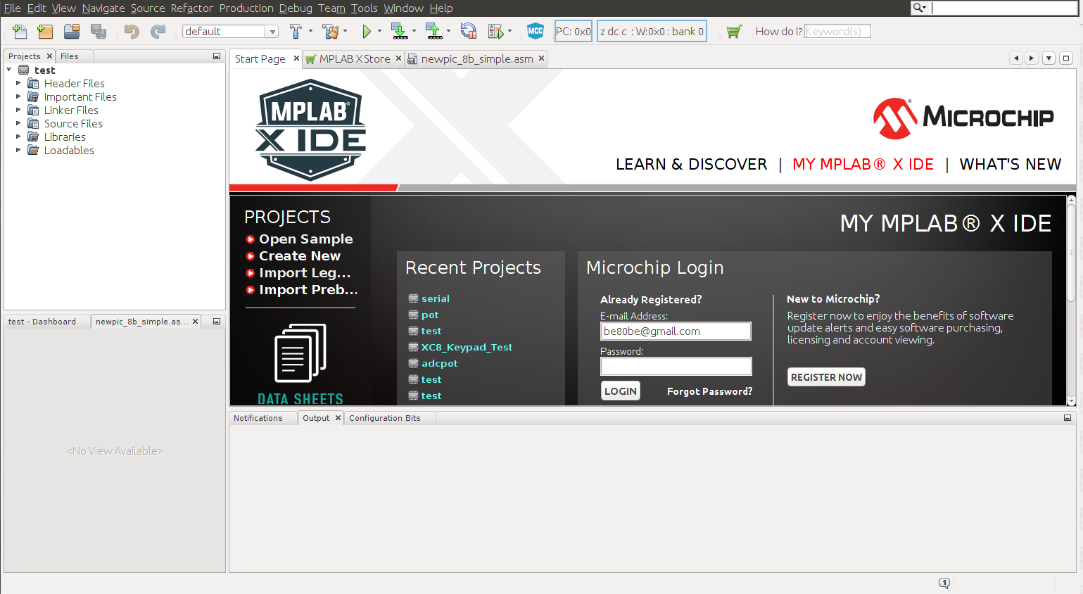

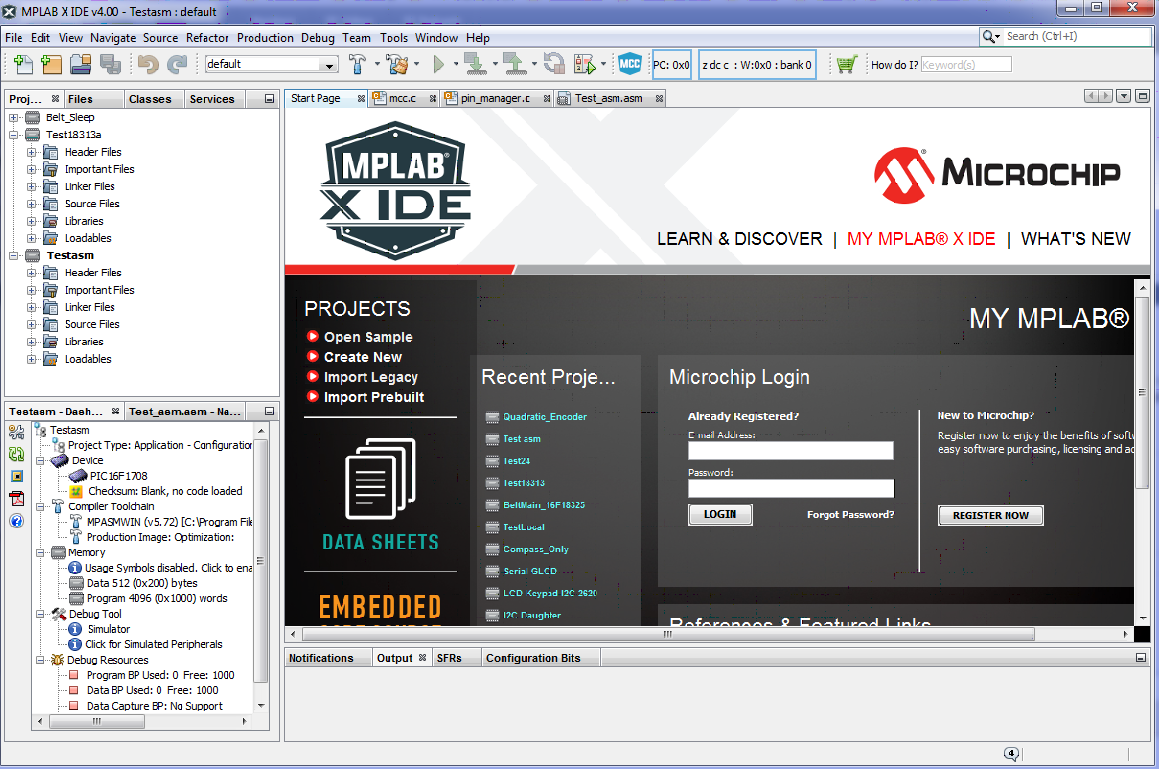

I'm using version 4.00 and have just closed and opened it and here is a screen shot.
Note the open projects on the left and the open files at the top.
Mike He got the same thing he had open LOL it's like you said when you reopen it's the same as you left it LOL
I do that all the time close it and not shut off the sim it comes back up just as it was

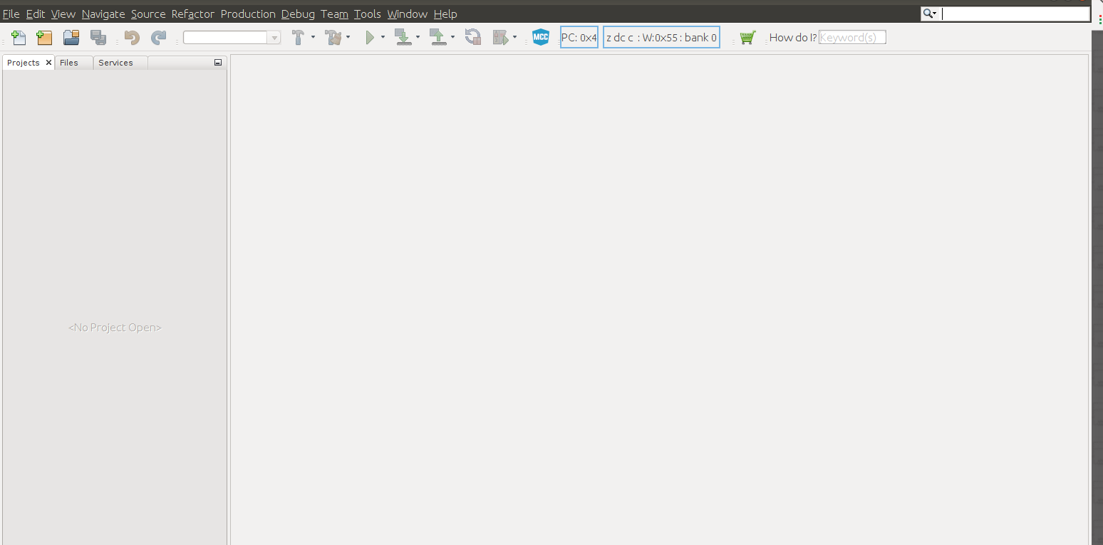

Normal window
When I close it after closing project
You get it where you left it. If I had sim it would of looked like his post
I like to never figured how to get a window back but now it's not bad I kind of like hiding them so I have a bigger editor

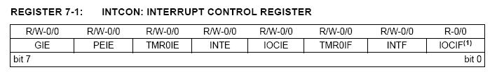

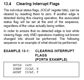

I notice you have
That flag bit is read only:
And you have to clear it in the appropriate register for which you set the IOC, e.g, IOCxF (probably Bank 7):
That probably explains why IOCAF remains set.
John
I disagree, at least with those chips. One must clear IOCxF. Reading the port is not necessary.
Using MCP logic, that makes sense. For example, If IOC is set only to a rising edge, it will not cause an event on the falling edge. Thus, there may be no detectable change in the port pin with a fast pulse. The flag, however, is a long-duration indicator of that change.
