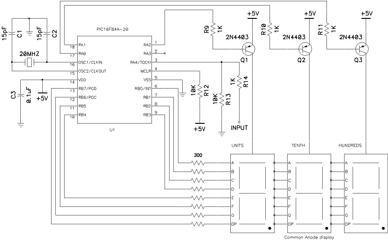

help!!proj using p16f84a chip....
galdz03
we have a proj in school using pic's..
problem is using the pic16f84 chip as the main ic to a 4 digit led display voltmeter.........

Anyways galdz03. Here's an example of how to connect your 7 Segments display.
mmm you'll be short in i/o soon if you have to use external ADC...
between the PIC and 7 segment, use a drive like 7447 will give you 3 extra i/o. Using a LED driver like MAX6958 is another choice

The real question is how your professor wants the voltmeter ADC built?
Using ADC chips or discrete components like opamps and comparator?
