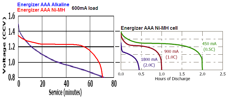

My electric model airplane uses AAA rechargable Ni-MH cells that deliver 5A to 8A without any problem for takeoff. Alkaline cells will just curl up and die.
Really? I was always under the impression that Alkaline cells were better at sourcing current than Nimh (though I have no reason for this belief)

I vertically stretched the AAA Alkaline cell's curves so the voltages fit on the graph of Energizer's AAA Ni-MH cell. The Ni-MH performance is MUCH better than the alkaline at 600mA. Each charge lasts as long as an alkaline battery cell and the voltage stays much higher.

No, NiMh and NiCd can provide MUCH higher currents than alkaline or conventional batteries - to the extent that you need to be careful with them!.
I think I just assumed because the cell capacity was higher the current source ability was. The voltage curve during discharge is pretty ugly too.

I remember old Ni-Cad AA cells with 500mAh capacity. They are still available inside new garden solar lights. My new Ni-MH AA cells have 2500mAh capacity, about the same as a new AA alkaline cell.
