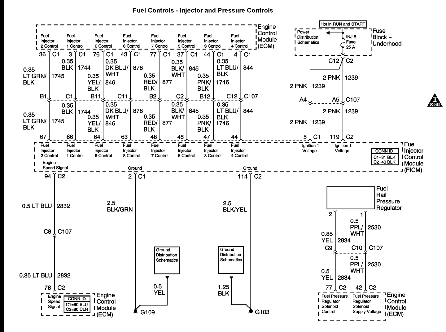

The fuel rail pressure sensor gives the ECM an indication of fuel pressure. The ECM uses this information to regulate fuel pressure, by commanding the fuel pressure regulator open or closed on the inlet of the fuel injection pump.

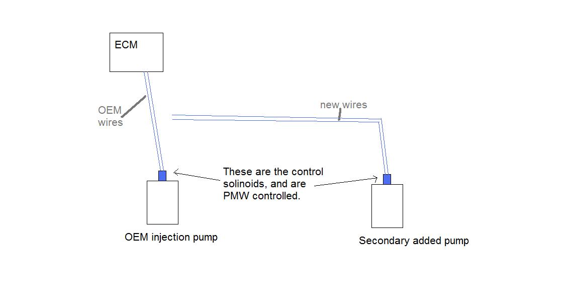

i made a crappy paint pic and a OEM diagram:eek:
It doesn't make sense to me why you cant use the same pwm signal for both solenoids. The ECM will read the pressure signal and back off on the pwm duty cycle as the pressure increases. Unless the system would get unstable somehow by adding another pump (which is possible - I would assume it was designed for a single pump) the control signal must back off as the pressure increases which means both pump valves would be restricted at the same time. Adding a second pump will just increase the rate of pressure build up which would mean less on time for both pumps. I suppose you could get an overshoot on the pressure but what other signal would you be able to use to control the second pump?
From your drawing, seems the ECU provides the actual "driving PWM" signal to the pump (maybe that's why it's sensitive to changes in the driving voltage). Perhaps the ECU doesn't have the "balls" to drive two in parallel so maybe all's you need is a "buffer/driver". Aside from that, OutToLunch's aguments are all valid.

Ya, even me lookin at the diagram, and beenings it a PWM signal, it would seem possible to tap into the existing wires. I didnt think of that OutToLunch, I think your right! The OEM system was never designed for 2 pumps. IIRC there are 4-5 or more companys that make the "Dual Fueler" kits, as there called. They all have a "box" that splits the signal to run the 2 pumps, whats in there boxes, no idea. I remember asking if i could just tie into the orig wires, and they all said no, too much psi. It could very well be an instability issue lookin now, ECM cant keep up fast enough?
Im not entirelly positive but is/couldnt the PWM signal, although a duty cycle, be 0-5v variance? If so, in my head it still kinda seems like that signal getting chopped in 1/2, would still split the voltage down? Or dosnt matter?
One other thought i had is that maybe the aftermarket boxes in these kits are intercepting the return signal to the ECM and are cheating/adjusting the signal back? Maybe tricking the ECM into thinking theres too much PSI so its output signal is correct for 2 pump operation?
I forgot!
Like said, the pump is purely mechanical, The only part electric on it is the 2-wired, duty-cycle controled fuel pressure regualtor (FPR). So its the only thing controlling the actual fuel psi. The ECM looks at other things, like the fuel psi sensor, and coolant temp and TPS signal and such to calculate the needed psi and hence demand the FPR to the desired position. The FPR is: Max fuel psi= low duty cycle / Low fuel psi= high duty cycle. Like if i unplug it while the engine is running, the pump creates max pressure.
