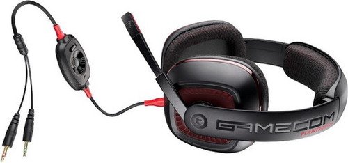

Hi guys! This is my first post here because I'm in trouble finding a right solution to repair my headset. So this is my headset:
And I broke to two jacks and lost them. The cable is cut before the plastic splitter and I´ve got an image with the cables. There are 1 green, 1 red, one copper cable, and one larger copper cable with a white cable inside of it. I've searched in the internet for a solution but the DIY's I found was for headphones with micro, in this case I have 2 TRS jacks, instead of one TRRS jack.
The image:
I don't quite understand the connections I have to make If I order 2 jack replacements. I assume that the green and red cable and the copper cable are for the Audio jack, and the other one should be for the micro?
Has anyone got a situation like that? I'm a little lost, don't know what else to do.
Thanks in advance.
Best regards,
João Dias

Just a guess, but I'd say the red is right, green is left, single copper is common; the copper and its white wire would be the microphone (white is positive/active, and copper is return/gnd)

Ok thanks for the message. The model is Plantronics Gamecom 367 K1.
I thought the same, although I wasn't sure of. I'll buy TRS jack replacements and I will try to connect them, and I hope I could have more replies until that.
Thank you for all the support.
From what I can tell dougy, you are right. The screened cable with the white inner cable is the mike connection and goes to one jack plug and the green and red cables are the left and right transducers with the copper wire being common, and go to another jack plug.

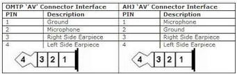

JD,
Be aware that wiring a jack isn't as straight forward as you'd think:
or
or
Ran into this with a throat mike/earphone rig. Depended on what type of device it was being attached to...
JD,
or
or
Thank you cowboybob for the reminder. But the examples are with TRRS jacks, I'm planning to use two TRS jacks, to match the original wiring. Are there any different wiring options with jacks TRS as well?
''' I'm planning to use two TRS jacks, to match the original wiring. Are there any different wiring options with jacks TRS as well? ...
Not that I've seen, other than R and L (T & R) being swapped in stereo apps.
