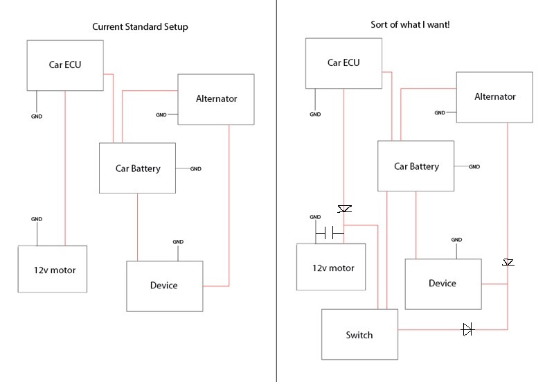

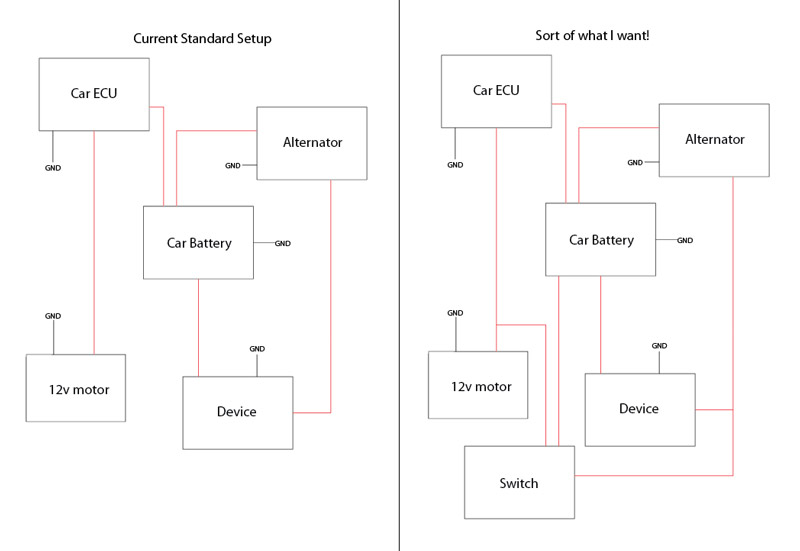

I've attached a very basic diagram of what is currently there and what I think I want. For now I've excluded the 2nd Battery as it may not be neccessary and is easier without it.
The modified diagram on the right simply has a SPST switch added at the bottom with 12v going in one side (would be a fused connection) and 12v going out on the other side to two things, one is the motor and one is the device.
What I'm worried about is 12v then going to the ECU and 12v going to the alternator so I would need some sort of protection there but I wouldn't want to interfere during normal operation. The device has a low voltage cut out at 10.2v and an over voltage cut out at 16v. The motor is just a standard 12v Bosch brushed DC motor.

Your device has a main supply, so it is highly likely that the control input to it will work fine when it is fed with nearly 12 V. A simple diode between the alternator and your device will stop current from your switch feeding current to the alternator.

Would something like an IN5402 diode be big enough, the datasheet says it handles 3.0 Amps of forward current, for the D+ line that will be fine, but for the Motor it may be a bit close.
The motor says it uses 16watts during normal operation which is about 1.5amps at most if the battery was a little low, but I wasn't sure if during startup it would draw more and blow the diode? Any advice on this?
Hi. Based on your description and circuit, you may want to put 3 diodes in, and possibly a capacitor or RC snubber across the motor. The diode between the switch and the device is needed if the motor and device are connected to the same terminal of the switch.
The diode(s) to the device can be any common diode you feel like (e.g. 1n4001/2/3/4/7) and the diode to the motor could be the one you suggested. If you're concerned about the diode heating up, connect 2 in parallel - but 1 should be fine.

Is the extra diode just to make sure that the motor doesn't pull any current from the low current wire from the alternator and melt it?
Is there a better kind of switch that could be used to prevent the need for this?
Yes. It can be a small signal diode if you wanted (e.g. 1N4148); while the 1n400x would still be fine.
Yes. If you use a double pole switch, just connect 1 pole to the motor and the other to the device input. e.g. N/O1 to device, N/O2 to motor, CMN1/2 to the battery.
