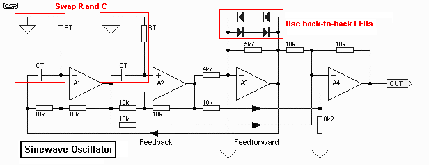

I made this circuit, using MC33077 high-speed opamps, a dual supply and LEDs. I swapped the R's and C's for lower distortion. It reached past 100kHz:

It's the price you pay for low distortion, if low distortion isn't an issue you can use diode clamps (as in your circuit) - but distortion will be many times higher.
